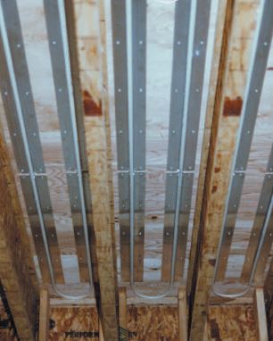

If water temperature at cistern remains cool during the summer use heat exchanger in cistern with underground piping to cabin with digital fan coil for cool air. (via Uponor EcoFlex insulated twin pipe) drain during winter months. The other alternate is Uponor "Joist Trak - staple up" aluminum radiant plates under sub-floor with 1/2 pex then install rigid insulation for radiant floor cooling with added dehumidifier.
# Posted: 18 Dec 2013 08:37pm
I would be hesitant about installing a radiant system in a hot humid climate and then using that system for cooling. The cool pipes will naturally pull moisture from the air through any crack in the flooring, or around the baseboard and cause condensation on the pipes. It may take a while to happen, but I think eventually you will have a lot of mold and rot around those cool pipes. Warm (or empty) pipes shouldn't have any problem with condensation.
