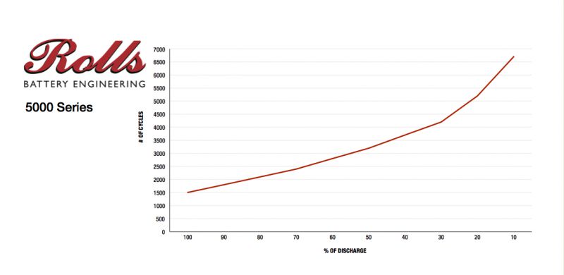

 Battery lifespan vs. depth of discharge, From Rolls Battery Engineering....
 and below is a graph from Rolls. Lifespan measured in  number of discharge / recharge cycles.
 |  rolls 5000 series DFoD vs Lifespan

 solar people say to use only the top 10%
 the site you posted says its most practical to use 30-40% which is 2-3x the batteries you need
 that makes more sense to me
 if you buy batteries to use only 10% then you have to buy about 3x as many batteries as if you are ok with 30-40%
 and maybe they dont last as long but your scrapping 3x not 10x thats a big cost and a big waste too
 you have to hope battery technology is better at the next time you need batteries but you can never know maybe the price of lead goes thru the roof....

 If you have talked / corresponded / read onfo, from solar people and they have said only use 10%, I would make a note to never deal with or listen to them again. The couple of "experts" I know have usually picked 20 to 25% as an ideal daily rate. Going to 50% has often been touted as a "next to" ideal amount as that makes it easier for many to afford the batteries they need.
 I went with an aim point of 25% and we usually do better than that.
 I'm not holding my breath for cheaper batteries.

 As for the battery depth of discharge issue.  As you can see from the chart lower depth of discharge means longer life.  Personally I want to be at no more than 10% DOD but sometimes you get a cloudy stretch.  Yesterday I was 70 amp hours down on my 244 amp hour bank...it's not the end of the world.  I use cheap ass batteries and have small loads YMMV.
 Pick a reasonable DOD number like 25-50% and then spend money on more efficient devices.   Buy a solar fridge, led lights, DC water pump, smaller microwave.  Also look at lifestyle factors....can you eliminate the microwave and use the stovetop instead?  Can you cook toast in the oven rather than use ann electric toaster?  Do you really need a hair dryer when a hat will do?   Questions you personally need to answer.
