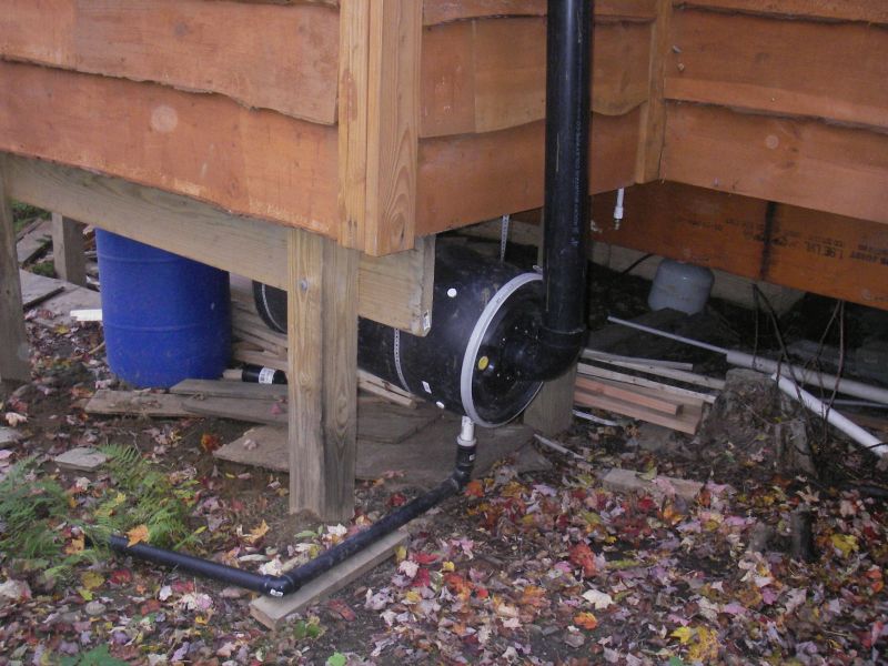

I made my septic out of a 30 gal barrel. The toilet (a 2-pint flush RV type) flushes down into the tank which has a mix of peat moss and wood shavings. A screened pipe allows liquids to flow out of the tank to an evaporation bed. One end has a 6 inch diameter "chimney" to dry things out as well as pull odors out. The barrel rotates on two closet flanges, one on the intake end and one on the chimney end. This mixes and acelerates composting.
I posted the idea for this system on here last year, but now after one year of use, I can say it works great!
At any rate, if you build a tank, it will eventually need to be pumped out. With my compost septic, I'll just need to remove a few shovel fulls of non- foul-smelling compost every few years.
In the photo below: The septic barrel is black, the grey water barrel is blue.

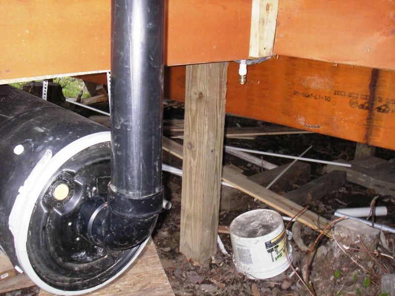

Here is a closer view. You can see a band clamp that allows me to "unlock" the barrel lid in order to access the compost. Adding compost is done from the toilet above. If you do try this, make sure you:
1. Have a chimney (the 6" pipe going up) that is high enough to provide a draft into the chamber. I slip the chimney pipe off when I need to access the lid.
2. Level the barrel so that liquids will flow into the drain pipe, depending on where you mount the pipe.
3. Mount the drain pipe to the barrel so that it can be disconnected easily when turning the barrel to mix the compost. There are several ways to do this... I used a tailpiece and coupling for a sink drain and it only requires hand tightening.
