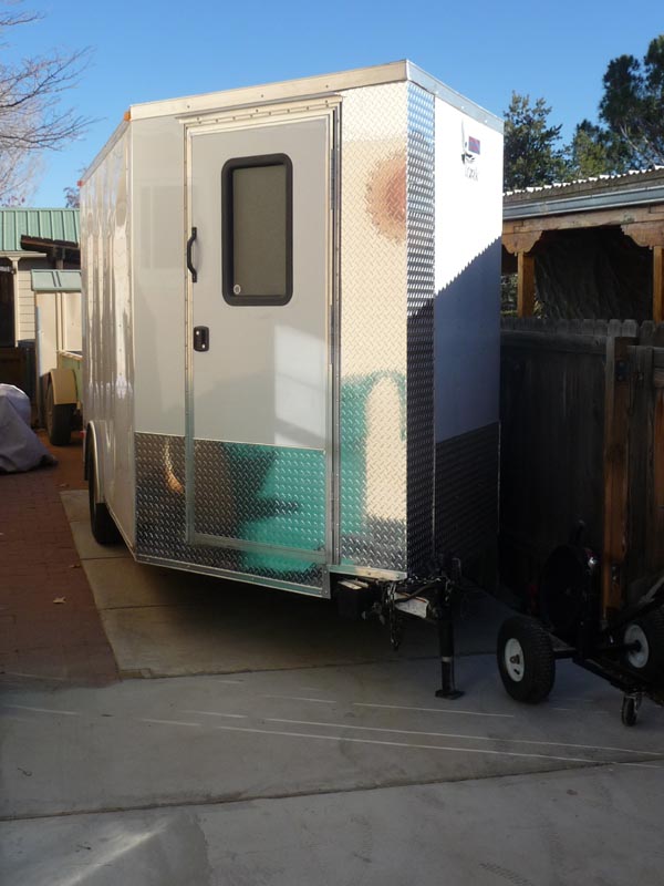

We bought a 6x12 by 6'6" interior height cargo trailer with a deep vee nose and an RV door installed in the nose. I'd rather not get into running a thread here as I don't want to run parallel threads on the topic in many different forums. I'll post a few pictures here later today to show what we started with and include a link to where the topic can be viewed. I'll go out on a limb and say that I believe that will be okay with cabinbuilder.

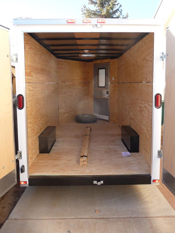

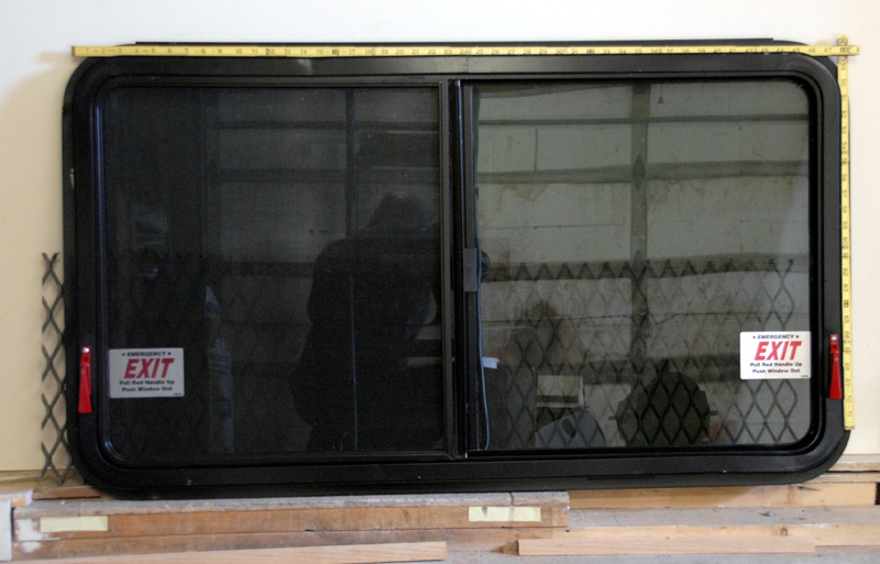

Couple of shots. sorry for the central lens flare in the interior shot. The window is 49 x 27, and is a slider with screen.
I have been doing the first layer of polyiso foam insulation and am not quite done.
Best. front
|  inside, from rear
|  RV window to be installed
