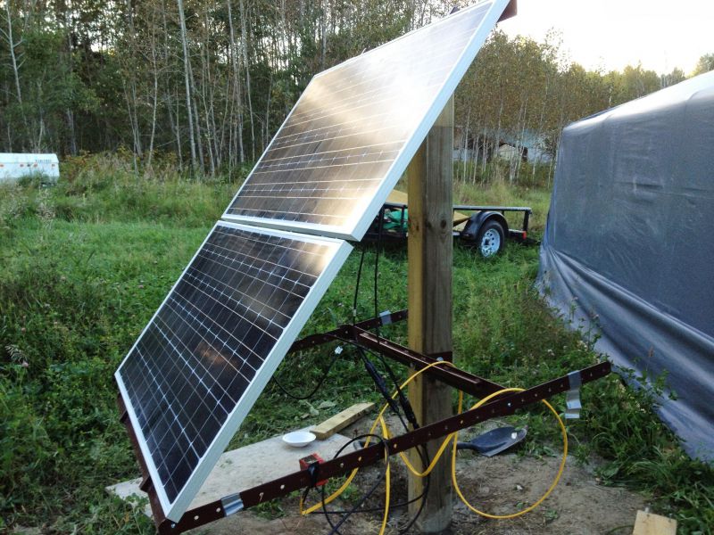

As far as mounting it or not, assuming you want it to continue to function when you are away, you need to mount it securely. Ground mount has the ability to allow you to adjust for the seasons (and this can make a lot of difference given you only have the one panel). In my case I designed something and my father-in-law welded it up. Easily adjustable a few time a year and did not cost a fortune.
