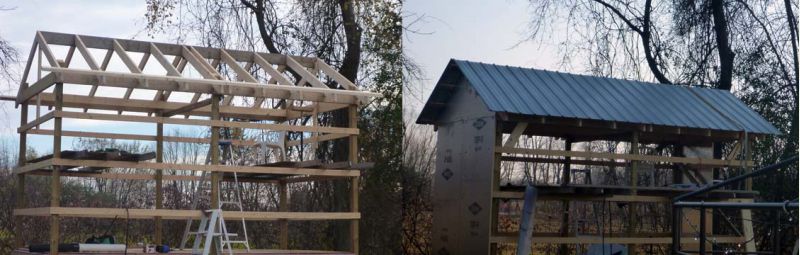

I built an 8x16 pole barn outhouse with walls insulated with 3.5" of polyiso. At -20 C (all temps are celcius) on a sunny day with 24sq feet of south facing windows (6 of them, argon/e glazed ... repurposed at $6 ea.) it was -3 inside the outhouse. It had been -27 that night.
Because it's a pole barn frame i did not use any wood cladding. The building is clad entirely with polyiso. 1.5 exterior recycled between the girts (2x4). And two layers of polyiso 1" foil clad on the exterior.
Yesterday. At -4 inside at 6 a.m. (-17 exterior temp) it was 5 by 2 p.m. on a bright cloud day. It is currently plus 14 at 9 a.m. but the heater is back on! Still the heater is set to 8-10 and the sun is now providing the heat. It is -14 outside with a strong wind. Wind chill is reported at -21.
Because of the R value fluctuations with polyiso. I will probably add 1" of xps before cladding the building. I have 4" of xps on the floor. 1.5" iso in the ceiling with 6" of roxul on top.
Because the insulation was recycled this building was quite cheap to build.

Can't tell by your photo if you have air-sealed the rigid foam joints. Taping and caulking all joints and connections will go a long way to slowing down heat loss and increasing comfort by blocking drafts.
Also, have you sealed the sills, top plate and rafter ends (at the blocking). I find the hardest part of pole barn finishing is the roof-ceiling to side wall connection.
Nice, crisp construction details in what we can see.
