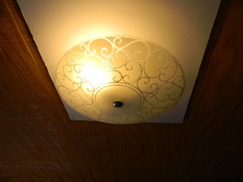

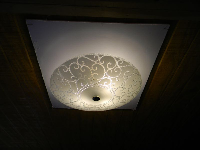

Purchased some cheaper 12v LED bulbs off Ebay:
http://www.ebay.com/itm/171060420229?ru=http%3A%2F%2Fwww.ebay.com%2Fsch%2Fi.html%3F_s acat%3D0%26_from%3DR40%26_nkw%3D171060420229%26_rdc%3D1
Per specs, 3 of these should ~ 1-15W compact fluorescent lumens. I think these came up a bit short on lumens, so I'll be adding a 4th LED. These LED bulbs each draw .2 A at 12 volts (per my meter), or 2.4 watts versus rated 3.8W (which probably explains less lumens). All in all, not too bad of a result for $3.50 each.
Note CF and LEDs are not same "color" light. (see attached)
I ordered 4 LED bulbs originally, but only 3 would light. After careful inspection, noticed a sticker stating "110 V". It worked when plugged into higher voltage, and the seller is sending me a replacement 12v bulb.
I'll be upgrading my "reflector" over the fixture. The white cardboard will be replaced by aluminum flashing. It'll reflect more and provide more safety should a Chinese LED bulb catch fire...
I ordered a few more with candelabra base for another cabin fixture. Should be plenty of light for a 14' x 24'. 3 LED bulbs pulling .6 amps
|  1 CF bulbs pulling 1.25 amps
