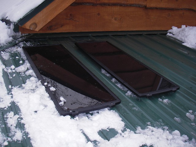

I just finished a solar system at my cabin 2 weeks ago and no longer need to deal with any of this. The total expenditure was less than $350 and relatively easy to install once you understand how it all goes together.
- 2 solar panels (15 watt amorphous type) $80 ea. on sale from norther tool x2 =$160
- 1 charge controller from northerntool.com $27
- A deep cycle marine battery (118 amp hours) from AutoZone $80
- 400 amp inverter from Home Depot $40
- Wiring, outlets, compact fluorescent bulbs, misc electrical supplies $40

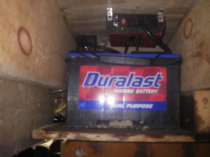

Quoting: unixfmike What can you actually power from this? I'm currently looking at solar systems under $1,000US and would like to know what your particular 30 watt system powers. Ultimately my goal is to provide power for the following : Real world usage for a family of five, to power 4 compact flourescent bulbs (1=23Watt, 3=9Watt), 2 led nightlights, run the kids portable dvd player, 1 digital alarm clock and cabin alarm system (only uses power when triggered) is approximately four days on a fully charged battery. The lights are turned off when not in use and ocassionaly we plug in other entertaiment devices, such as a radio or kids video game charger. The 30 watt panels are for charging the battery. The battery itself is what determines capacity and in this case my 118 amp hour battery for $80 was the most cost effective I could find (time will tell how durable it is). I'm planning to hook up another identical battery in parallel to double the capacity. Ideally, I'd like to have three batteries and a few more panels, but this suffices for now. For now when we are there for an extended time and we run the battery down, we go back to basics and use candles, oil lamps, an aladdin lamp and even a propane lantern. The battery can also be recharged with a generator and battery charger as another option.
Be careful powering a fridge, I have a mini fridge that I tried powering and it sucked the battery dry in less than a day. Now we use a huge cooler that keeps ice for about 4-5 days in the summer. If you are set on a fridge, look into propane. anything from full size to mini ones that go in RV's are available. Battery/inverter setup

You should keep inverter turned off when you are not using it (i.e. when you don't need 110V for appliances) - it drains energy even when idle and no appliances are connected.
Keep solar panel, charge controller and battery always connected - this will keep system always charged and ready. The purpose of controller is to maintain this and it will not overload the battery (unless it is faulty or something).
