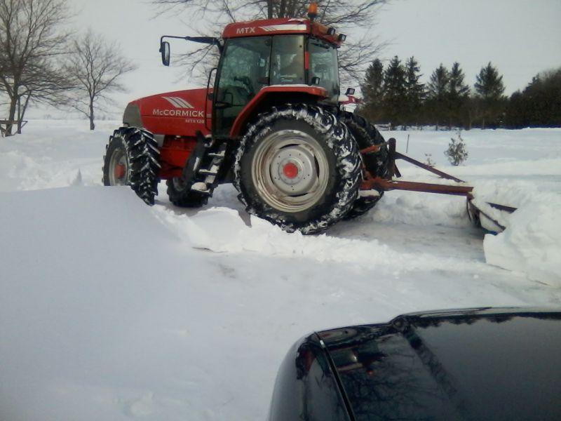

took this guy 1.5 hours today 300 feet of driveway at my home
MI drew

Nice looking McCormick, Just. How does it do in the snow without chains?
