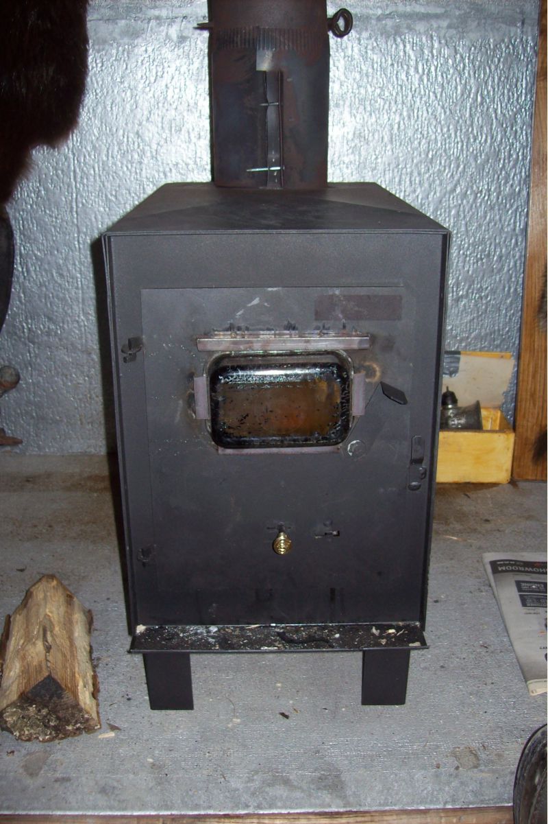

Neb used one just like this in his camp...look for his thread on here
# Posted: 15 Feb 2014 08:52am
Here is what I did and has worked out very nice. I did mine through the roof and instead of the wall or window like in your case. I can tell you it will heat up a small cabin but you will need to feed it more often. I have had no issues with getting to hot on outside walls or where it goes through the roof. I can put my hand on any part of the fire wall or ceiling when at full burn and not even close to being hot. It works pretty well.

Neb, what are you using for stovepipe there? I have a big cast stove for my 16x16 but I am afraid it will be too big. I have been looking at the Cabelas pack stoves but I am not sure how robust they are. For under $300 it might be worth a try though. Or I can try and find some plate steel and make one myself but steel costs a fortune up here.
# Posted: 15 Feb 2014 03:21pm
I used muffler pipe. It was flex pipe and wrapped heavy foil. I was sure if it would leak. That hasn't been a problem but left it on any way. I'm at the shack today and had lunch. I fired her up and toasty warm. Mine is a 12x10 but it does the trick.
