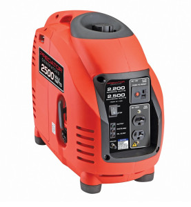

[]has anybody tried the predator generators from Harbor Freight? Just got an ad showing a 2500 watt model on sale for 499. Rated at 64 db and consistant power for electronics. It looks like a knock off Honda. guess for the price I am curious
rmak
# Posted: 2 Mar 2014 02:06pm
It got mixed reviews on the site. A deal killer is the review that said it's loud.

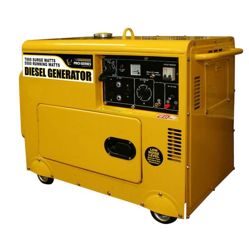

My main question is, which is best, diesel, gas, or propane?
$1000 'pro' mdl
$1000 'pro' mdl

Gary, not sure on altitude. I know early Toyotas injection pumps on their diesels had an altitude compensator. But if the diaphragm ripped, you couldnt go up too high in elevation without a big power loss. I suspect these rigs just dont have the HAC (high altitude compensator)
I suspect the diesel generator is a 4 pole unit, meaning it gets 60Hz at 1800 rpm vs the 2 poles that get it at 3600 rpm. Maybe motorhome gennies use 4 poles. Diesel generators are heavy. All diesel engines are super heavy. Diesel is dirty, it contaminate the oil, while propane is the easiest on engine oil. I'd get the Honda EU6500is, it rolls around, heavy, but way lighter than that diesel and probably much quieter. But cost is 4K though.

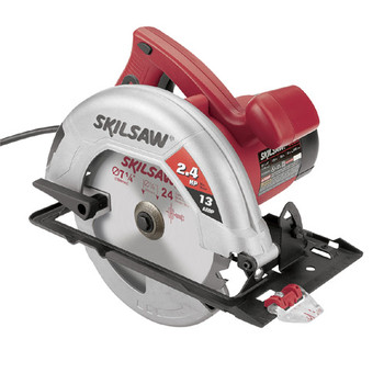

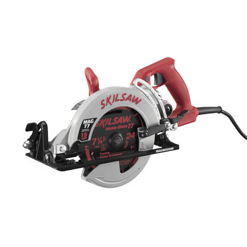

What is a worm drive saw Toyota? My gen just stopped working...ran for hours, shut it off and tried to start it two minutes later and wouldn't fire up so I may be in the market for a new one. But I need it to run power tools like a compressor and circular saw.
# Posted: 5 Jul 2014 09:02pm
My Generac 1600 watt bit the dust so my Honda EU2000I is still(by far) the best generator on the earth!It start's with one half tug on the cord,is so quiet that you can't hear it from 50 feet away and keep's me in electric day after day after day!
# Posted: 5 Jul 2014 09:15pm - Edited by: toyota_mdt_tech
Quoting: Smawgunner
The motor axis is at a right angle to the blade, there is a transmission on it, so it takes a bit more energy to fire up and get spinning. Mine is the Skil brand, red handled unit which means its the magnesium case. I only paid $179 for mine, but that was years ago from Home Base! Anyone remember Home Base????
The blade spins a bit slower, more power, and the armature spinning like it does acts like a gyro and helps to keep the saw going straight on those long cuts. And when you release the trigger, it stops rather quickly.
Few pictures to show the difference. All mfg make worm drives, ie Skil, De Walk, Milwaukee, Makita etc. All the pros like worm drives. Heavier, more money, but much nicer to use.
The Honda EU2000i will run a compressor, but get the diaphragm type. I have a table saw from Porter Cable, consumes 7 amps, more on start up, EU2000i runs it all. I use the Honda EU2000i to build my cabin and it ran everything I threw at it and all in the "eco mode" which keeps it at a quiet 45 db or so.
The Yamaha is decent, but a distant second place choice. the bigger motor, consumes more fuel, doesnt run as long and when you shut it off, you have to turn the engine off, then turn the fuel off. Honda, its done in one action by the same switch/lever. And it appears the Yamaha is $10 less.
Skil Brand "worm drive" Circular saw
Skil Brand circular saw

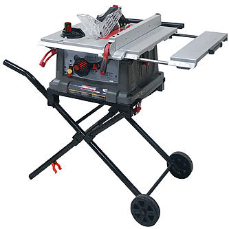

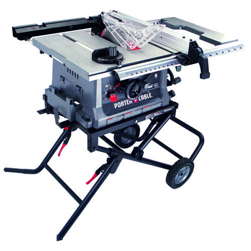

Gary, those older more fixed type table saws consume loads on start up.
Speny the $$$ on the EU2000i, then get some lower consumption table saw and stil be way ahead. I have never drug out my big gennie to the cabin. I would hate doing that. I took into consideration when buying all my building tools, "would the EU2000i run it". I have always wanted a table saw, but the weight and the fact they are hard to move around, I put it off. Then I saw the portable fold up units from Lowes, it consumed 7 amps and was light and folded up, rolls around on its own wheel like a hand truck. The EU2000i doesn't even know the table saw is plugged in. Doesn't even work up a sweat. I think I paid $299 for it from Lowes. Leave that big heavy older table saw at home or toss it on craigslist.
Specs shows 15 amps, but I think that is the circuit you plug it into (std/typical) and I have never stalled it nor did it even load down. I usually use it to rip sheet plywood or trim work, ie 5/4 cedar build bird houses etc. Has a nice fence, adjustable blade angle, adjustable push etc.
I made sure anything I bought for tools would work off the EU2000i. And it all did. My worm drive saw and shop vac uses the most and only on start up. But still ran all with ease. It ran my compressor easily.
http://www.portercable.com/products/ProductDetail.aspx?ProductID=24026
The Lowes Link, shows it for $299. This is a 10" table saw.
http://www.lowes.com/pd_510902-46069-PCB222TS_0__?productId=50146380&Ntt=table+saw&pl =1&currentURL=%3FNtt%3Dtable%2Bsaw&facetInfo=
I have a good buddy who bought the almost identical unit I had from Sears for $199, it looked identical to mine, suspect same mfg, but had Craftsman on it instead. Here it is.
http://www.sears.com/craftsman-cm-craftsman-10-in-portable-table-saw/p-00941503000P?p rdNo=4&blockNo=4&blockType=G4
Here is a great video with the EU2000i and a table saw.
http://www.youtube.com/watch?v=_Sj-mfVpjkw
Porter Cable table saw
Craftsman Table Saw From Sears

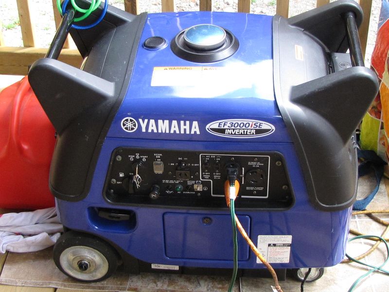

# Posted: 25 Feb 2017 05:26pm
Hey Fishinator, keep your eye on Kijiji....I live in Sarnia, Ont. and picked this up for $1500. mint and hardly used.
RMAK....I get the fact that many of us have to pick, choose and prioritize our $$$ when thinking of the cabin. I picked up this $600. Firman 4450 Generator at Lowes over Christmas for $299.00 as an emergency back up...will come on sale again. It has a cover and wheel kit and for $299.00 I have little to lose. I start it regularly...first pull, no prob and decibal rating is 68...not a Yammy or Honda...but a lot quieter than others you pay more for.
Love my Yammy...
Love my Yammy...
Impressed so far with this...
