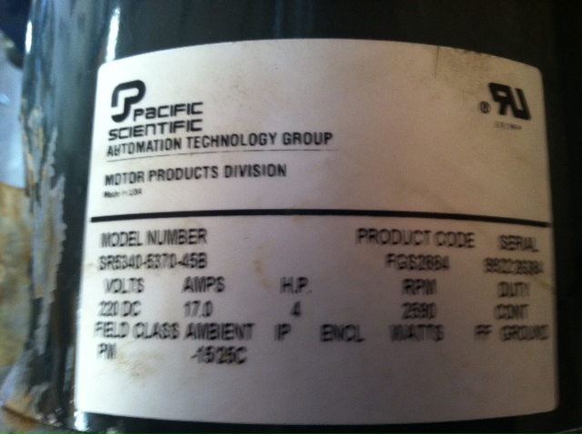

 I was at a local scrap yard today and came across a permanent magnet motor. I have been wanting to play around with a DIY generator for some time now.
 Anyways i ended up buying it. it is very heavy(70 lbs) it says 220 volt dc 17.0 amps and 4 hp is this something that can be used or is it to big?
 i can spin it by hand and get 25-30 volts ac out of it np at all. if i put my meter on dc i can get about 7-10 volts. no load of coarse.
 i assume after i figure out how i want to spin it then i wire the + and - into a charge controller and then to a battery or a bank of batteries.
 I want to use it to recharge batteries at the cabin.
 what would you guess i could get out of this at say low rpms (say 250) and at high rpms (say 2500)?
 Any thoughts and help would be greatly helpful.
 4 horsepower 17amp 220voltz DCContinuous Duty Electric motor
