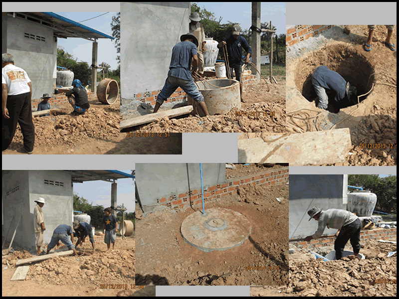

 I imagine that, here in Southeast Asia, a LOT of things done here would be big "no-no's" in the states.
 Here is a little collage of the construction of our 5,260 liter (~1,390 US gallons) septic tank. It is made up of four (4) equal in size concrete rings lowered into the ground, cemented together, capped, and vented. The bottom has several cm of gravel, but otherwise is open. As others here, it is exclusively for black water.
 Each ring cost $7.50c US. Probably the cheapest septic tank installation I will ever pay for in my life.
