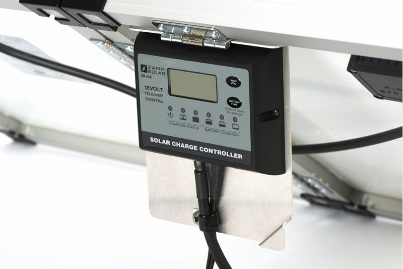

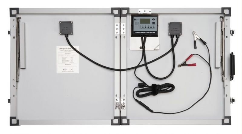

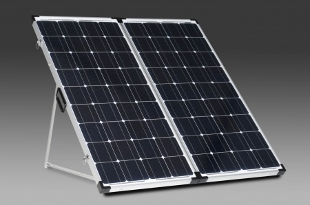

 I've been looking at portable folding solar panels to power our  outdoor shower water pump and a few other things at camp. At present we are using a noisy gasoline powered pump. I would like a quiet shower. I found that Zamp Solar out of Bend,OR makes some of the best on the market at this time. Don't have the funds for this set up this summer but have saved all the info in my cabin file.
 |  Zamp portable solar panels
 |  Charge controller on back is hinged for easy viewing and weatherproof
 |  Charge controller
 |  Padding carrying case

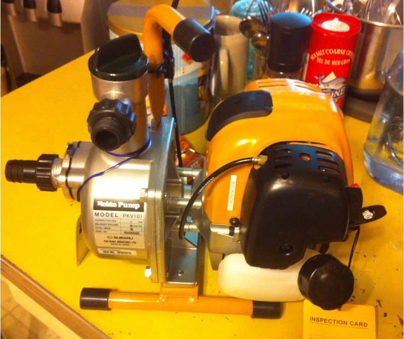

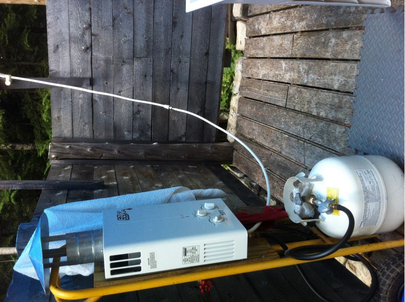

 | # Posted: 27 Apr 2014 11:44pm Reply
 The gasoline pump we use to pump water from the lake to our 250 gallon water tank and to pump water to our on demand hot water shower.

 | # Posted: 28 Apr 2014 08:28am Reply
 The shower:
