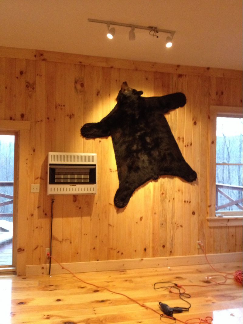

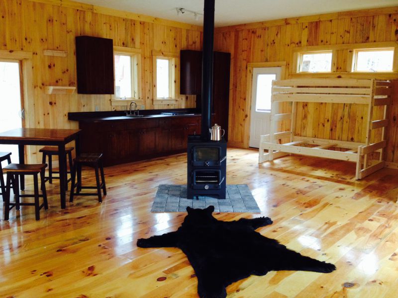

 I bought one as a supplement to my cookstove. I like that it works but I don't love the condensation on the windows it makes

 We have one and plan on installing it outside, removing it for winter. I think if you are a seasonal cabin user the price cant be beat.

 I'd put mine more in the category of surviving an unvented propane heater.
 This past fall thru winter I used my unvented propane heater and will be taking a second look at wood mainly due to the ever increasing cost of propane, the wide variations in propane quality and smell and the general inconsistant quality of the propane we seem to have around here.
 A vented propane heater would resolve odor problems but my beef is with the poor quality and overpriced fuel.

 The plan for mine is to use it until the cook stove heats up...like a quick source of heat when walking into a chilly small cabin although when temperatures are consistently near or below freezing....the cabin is closed for the winter
