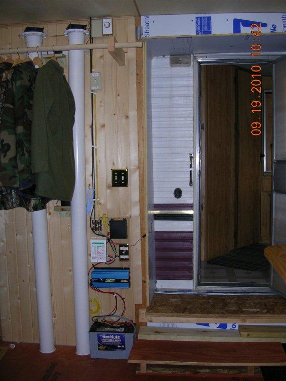

 My one panel system, run lights and older travel travel trailer. Before the pictures, used to bring up a charged battery each time, now I just flick the on/off switches, nice.
 Panel is a Kyocera 135, controller is a Xantrex C-12.
 in 2010 Panel $400, controller $80, battery $100, inverter $75, 12 volt dist box $20.  Shack is wired for 12 volts. Inverter runs vacum and power tools, have since added a small PWM inverter to charge phones, laptops, etc.
 No problems since 2010.

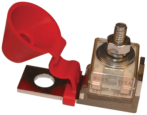

 Everyone discusses solar panels, inverters batteries, controllers, etc, but no talk about wire size for what, max lengths, grounding, etc.  I would love to hear about these if anyone has ideas.  I'm about $2k in so far but have to get some serious cables from the batteries - fuses???  Also need a battery monitor and would like something more than the basic so I can do some calculating of what I use and gain.Any thoughts on this?
| ILFE Member
 | # Posted: 26 Jun 2014 11:34pm - Edited by: ILFE Reply
 beachman,
 Quoting: beachman Everyone discusses solar panels, inverters batteries, controllers, etc, but no talk about wire size for what, max lengths, grounding, etc. I would love to hear about these if anyone has ideas. I'm about $2k in so far but have to get some serious cables from the batteries - fuses???
 I make it a point to have all wires of equal lengths. For example, my batteries are exactly 1.5 meters from the controller, making them 3 meters round trip. They are number 6 wire, protected with 50 amp fuses.
 Fuses that some people tend to use, and are more expensive, are by Blue Sea Systems. They attach direct to the battery posts, making them easier to access, seated on top of each battery. Here is a LINK to their terminal fuse blocks. (Image is attached below.)
 I use solid wire for grounding applications, and stranded for everything else (panels to controller, controller to loads, and controller to battery bank.)
 Although there are absolutely no codes to concern us here in Cambodia, there probably will be where you are located. So, that is one thing you should probably take into consideration.

| beachman Member
 | # Posted: 27 Jun 2014 04:09pm Reply
 Thanks IFLE.  I think I am starting to get the picture. I might try those fuses.
| ILFE Member
 | # Posted: 27 Jun 2014 06:22pm Reply
 Do keep in mind, the type of fuses we are talking about here are NOT cheap. But, they will keep your protection at the battery. Line protection at least near the battery bank is certainly a plus.
 To give you an idea of prices, check them out by using keywords "Terminal Fuse Block", on Amazon.com.

| creeky Member
 | # Posted: 13 Jul 2014 05:07pm Reply
 Those are some nice systems Steve, MI.
 Just a note for fuse blocking. I was swapping out inverters and a ground wire (I think) somehow bumped the live line.
 I was ever so happy so spend 30 bucks ordering a new 300 amp fuse... no other damage done.
