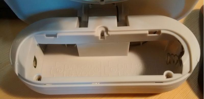

 I bought a small fan for possible use to assist in venting of hot air behind my propane fridge. The fridge will be in a sealed and insulated cabinet, vented to the outside near the bottom and the top.
 My question:
 The fan is made to run on 2 "D" batteries. Can I wire this to my 12v fuse box / battery bank by simply using a resistor in-line with the wires? I see inexpensive resistors that do 12v to 5v, but not 3v. (I need 3v, since the batteries are 1.5v in series... right?)
 Ideas / thoughts / corrections / insight?

 Very good chance the fan would run fine at 5 volts.  Simple resistors will not ensure a steady voltage if and when the input changes (it is much higher when being charged.  In addition you may have a lot of heat so a heat sink is needed.  You really need a linear regulator or Buck circuit - Google 12v to 3v and you will come across a number of schematics.
 Example of schematics
 I have one schematic  I used but it is on my  home computer and at the moment I am in the Rocky Mountains travelling.  I built a bunch of these a number of years ago so I could use the inexpensive puck type LED lights in my old Pop Up Camper.
 You can also buy completed 12 to 3 converters easily.  What I would really suggest is you just pick up 12v computer cooling fans.  They are very cheap and will do the job fine without dealing with any conversion.  In the RV world there are numerous examples of Propane Fridge Modifications that add fans that pass air through the absorption fins to increase the efficiency of the fridge.
