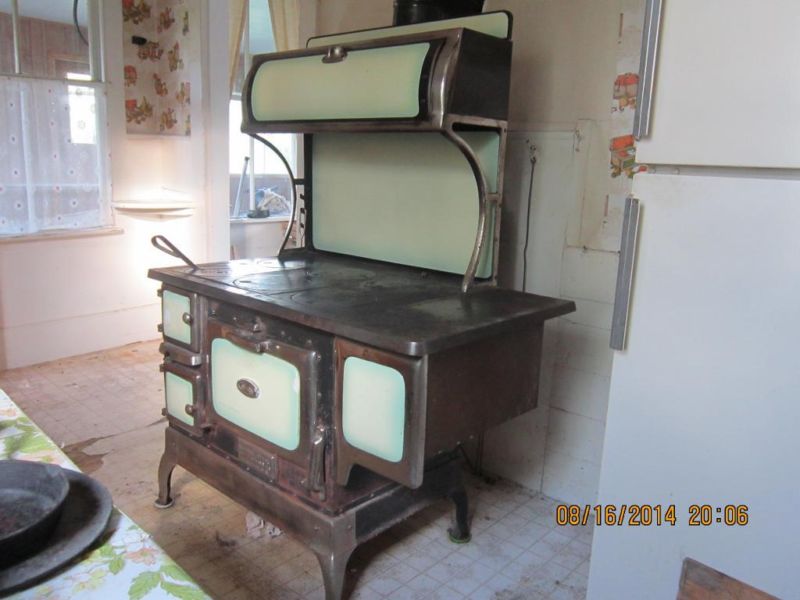

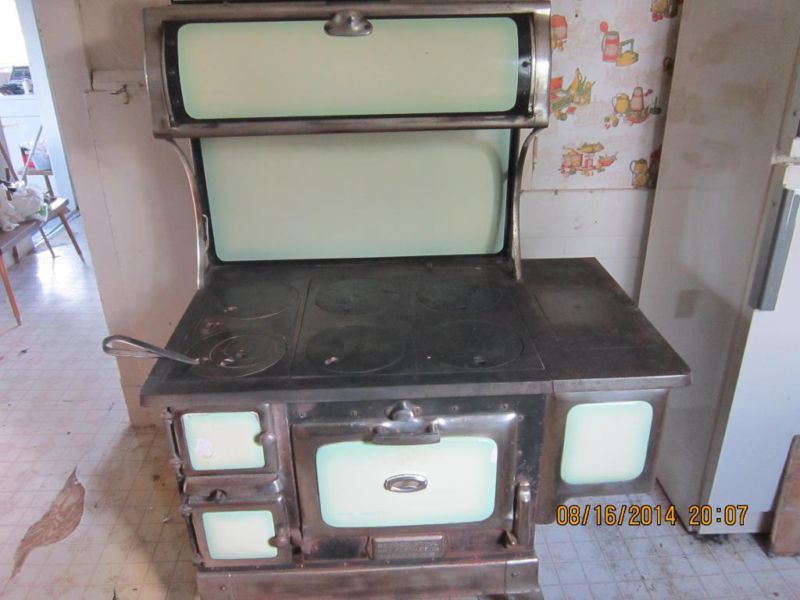

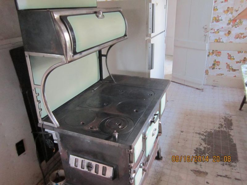

Hi
I have an opportunity to buy a very nice woodcook stove. I spoke to the seller and he tells me its in good shape but could use some cleaning. No cracks etc...
It was used 1.5 years ago but was fitted for oil burner. I assume that means a hole in the firebox. My question is can this be restored to burn wood and if so what am I looking at?
The seller assured it could be with a rivet patch or similar but he also wants to sell the thing. Its circa 1940.
Scott G
# Posted: 19 Aug 2014 09:35pm
Thought I'd add a bit more info and a couple pics. Don't have any pics of the firebox yet.
Royal Empress Manufucturer. Record Stove and Furnace Co.
It will need some restoring for sure, but I see a ton of potential here and a happy wife on her birthday (along with a large fire extinguisher).
Thanks.

Beautiful stove. I've always been told that you cannot patch old cast iron that is burned out on the bottom of a wood stove burn chamber. It's like patching worn out blue jeans- the patch is fine but the material that it is attached to fails. This stove might not be burned out in the burn chamber, but it seems to me that it has to be less than new after 75 years of use. I'd look long and hard before getting this, if intending to use it as a regular heat/cook stove. Cracks show failure, but just cause there are no cracks doesn't mean the cast iron is not compromised to an extent.
Cast iron crystalizes with age, in a fire box or not, making it more brittle and harder to repair.
As far as the rivet repair of a drilled hole, I'd try to find a web forum about woodstoves and get advice from a pro. If the hole is not located where coals are, in the bottom, I'd be less worried.

Thanks bldginsp. I hear you on the patch. I'll give this a thorough inspection for sure. Apparently there are no cracks but I'll bring a flashlight and such when I go see it, along with something to tap the surface and try to find weak spots.

I purchased this stove yesterday. They had an oil 'pump' type of system attached to the back, behind the firebox.
Honestly I'm having buyers remorse today. My excitement for this got the best of me. I paid $200 for the stove and upon further investigation after I got it home it's rougher than I thought. The top cast iron is in decent shape, one small crack where the warming oven bolts on. The sheet metal in the oven has some holes along with other spots on the body sheet metal.
I think I"ll get out the Brasso and Shopvac and clean it up to look really nice and try to resell on Kijiji. It would look nice as an ornament/decoration but I think it's more work that I want to invest to bring it back to fully functional.
My wife thought the gesture was really nice but is not interested in a fire hazard in the camp. Can't blame me for trying but I need to use better wisdom... Wanting to escape this ratrace drives me to make some dumb moves every once in a while.
