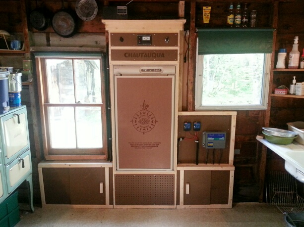

 I have in my cabin a Norcold N51 2 way(Propane or 120 volt), it's 5.5 cubic feet with a freezer compartment. It requires 12 volt power supply regardless of running mode to run the temperature control circuit.
 Only issue I have ever had is if you run in Automatic mode(default 120 electric) and you aren't actually hooked up to 120 volt supply, it runs in LP gas mode, if the burner should fail to light just once  it switches back to electric mode and shuts down because 110v supply isn't available. Since I now only run in LP mode it will reset itself and try to re-light up to three times. Hasn't shut down since I switched it to the LP mode and if I should plug into the generator(while working on propane system) I just manually switch it to electric mode.
 The 12 volt battery (100AH) to run it is charged with a 55 watt solar array and stays charged even in December here in Maine! I am fortunate to have a local propane company that believes in customer service and if I should need a 100 lb. cylinder or two in the winter they will drag them in to my cabin in the woods (1/2 mile) on a sled in the winter at no extra cost. I am extremely pleased with the performance of this refrigerator.

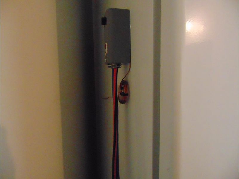

 I am going to be replacing a fridge...I am getting a danby I think it is the 10 cuft model with a freezer, cant remember the specs for sure but 290kwhs a year comes to mind. This is what I will be doing. it may work for your situation.
 You will need to get a aftermarket control..NOT a solid state one but one from a manufacturer like johnston controls, or maybe its johnson controls, they come prewired if I remember right. You will also need a timer, again NOT solid state rather a mechanical timer,Plug the timer into the wall set the timer so it runs roughly 8 am to 10 pm (roughly or whatever you like)
 Plug the control into the timer pluged into the wall, the fridge into the control. run the bulb from the new control into the fridge compartment (you can drill, or better yet just run it through the door opening the gasket will seal around it fine) and duct tape it to the side wall inside, though if you open your fridge a lot you might want to have the bulb part in a glass of water just for less cycling.
 Fill the freezer part with jugs of water. Now the fridge has its own thermostat control and what I have found is this control opens up a opening that lets cold air drop from the freezer compartment to the fridge compartment, you will need to play with this a bit but once you get it set right you will have the fridge keeping the ice frozen, this frozen ice is now your thermal battery, that lets you coast overnight without power. With your fridge set up like this you will be running it mostly of the sun, not off your batteries. Yes you have to be a little handy but this isnt rocket science. Yes I drilled through the side to put the bulb into this one, but if your not confident doing that run it through the door opening, that will be fine. ....Just what works for me
