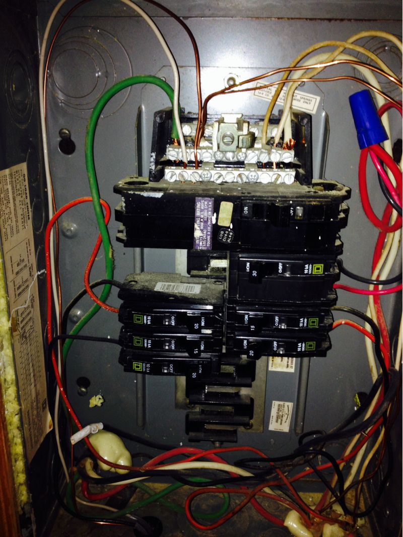

 I'll try bypassing the dimmer. As far as a "bond" with the neutral and ground wire in the panel box...that's a question for a licensed electrician to decipher...and not something I can afford right now. I can take a picture of the panel box and post it if that would help?

 Look for a green screw that is in the neutral buss bar (white wire). If there is a green colored screw in that bar that means the neutral wire(s) and the ground(s) are bonded. That is normal in a normal grid tie building. There is supposed to only be one such bond in the buildings electrical system. If there is no green screw in that neutral bar then there is no bond if all else is normal and correct.
 If this was wired by an electrician the probability of a bond being present is quite high.
 As was stated earlier most inverters and small generators will have an internal bond.  With two bonds in a system problems can arise.
 You can use a multimeter to check for a bond in the inverter or generator. With the items OFF, no power on at all, check for continuity between the ground lug on the receptacle and the wide slot, which is the white neutral wire. If the meter shows continuity between those there is an internal bond. IF the inverter has a built in transfer switch the above test may not be valid and a wiring diagram would have to be consulted. Or a call made to customer service.
| rugercpl Member
 | # Posted: 27 Aug 2014 11:02am Reply
 My panel box...don't see a green screw...a green wire yes
| MtnDon Member
 | # Posted: 27 Aug 2014 02:26pm Reply
 You can always use a multimeter to check if there is conductivity between neutral and ground, just in case the screw is hidden. But the green screws are usually reasonably easy to find. The meter is a sure fire method though.
