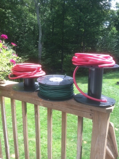

 I picked up 18' 1/0, 35' of 2 AWG, and 175' of 8 AWG 600v Marine grade Ancor wire for $20 at a barn sale. I think it's copper with individually tinned strands. Any reason this shouldn't be used for a solar setup? Thanks

 If the wire is exposed to sunlight make certain the insulation is rated for that.  With some wire the insulation will degrade with UV exposure and the outer layer will break down and come apart.

 Quoting: MtnDon If the wire is exposed to sunlight make certain the insulation is rated for that.Thanks Don, it only says water and oil resistant nothing about UV exposure. I'll contact the manufacturer.
