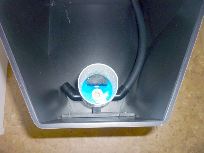

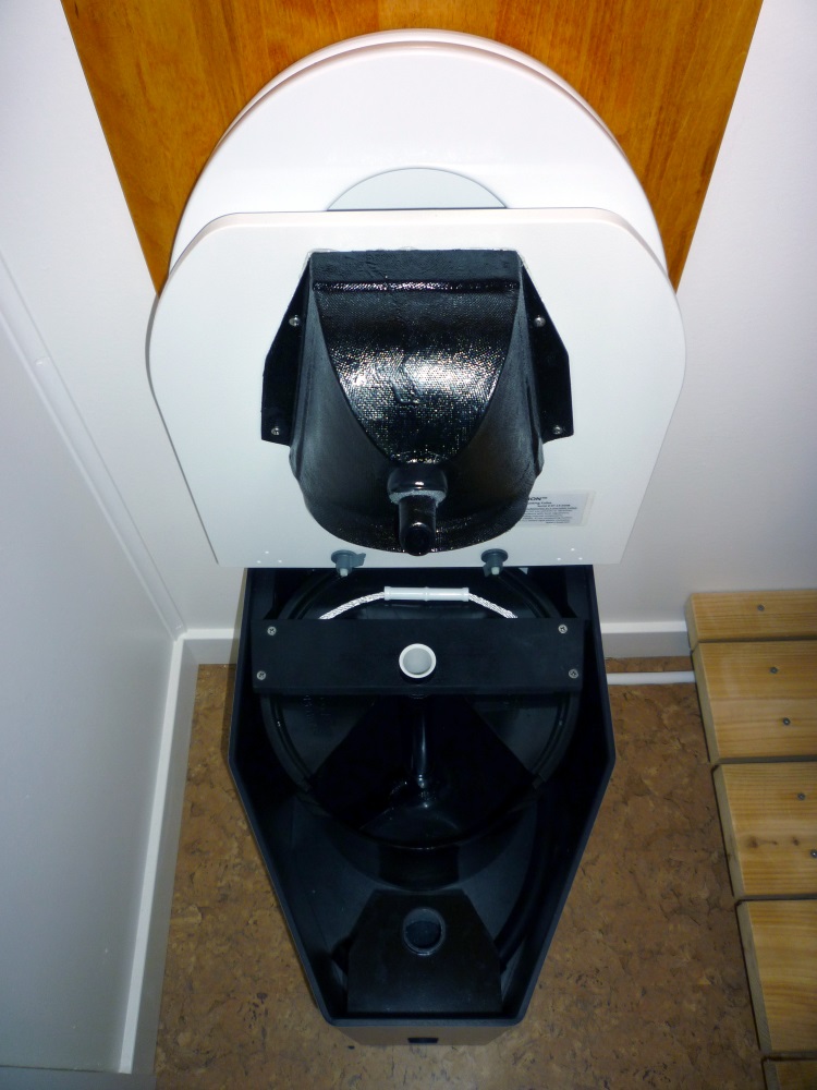

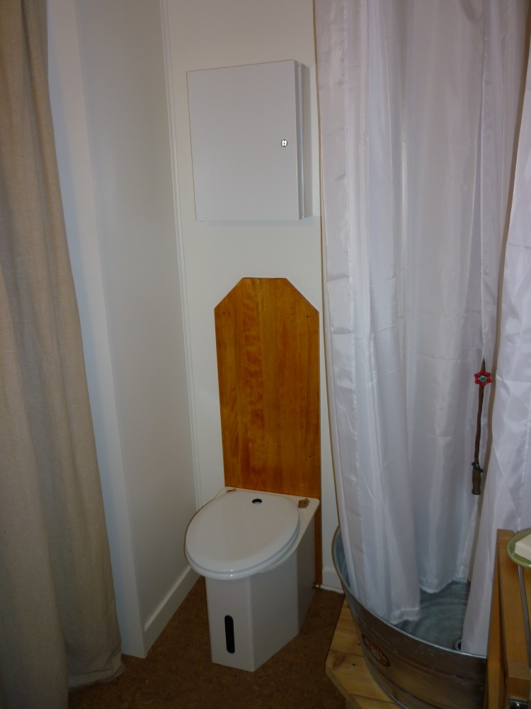

 Smawgunner:
 I recently purchased a C-Head composting toilet with the optional external urine diverter. My preference is for urine to be separated to control odor and allow for faster drying of the solid waste. I'd rather have the composting process take place outside in a composting pile.  I'm currently in the process of evaluating it and will post a full review when I get some more feedback, specifically from my wife.
 While the original C-Head did have a urine diverter, it was only diverted to an internal 1-gallon jug. What I wanted was one that could be diverted to my drywell. So, I talked them into making a version that would do just that. What I found is that a lot more goes into making a good urine diverter than just a funnel and some tubing.
 First, the diverter has to be properly designed and located to keep the liquid and solid streams completely separated. Second, it needs a draining system that can deal with a backup in the tubing (i.e. a bubble in the tube). Third, it should have some way to deodorize and clean the urine diverter. This last one is important as urine can have a strong odor and can also build up deposits which will affect function over time.
 I've included some pictures of the C-Head that should hopefully show what I'm talking about, although the pictures are a bit darker than I expected.

| Smawgunner Member
 | # Posted: 31 Aug 2014 10:58pm Reply
 That bathroom is cool! Love the shower. Mine will deposit underneath the cabin for solids and a leach bed for liquids. That set up looks just like what I need. Thanks
