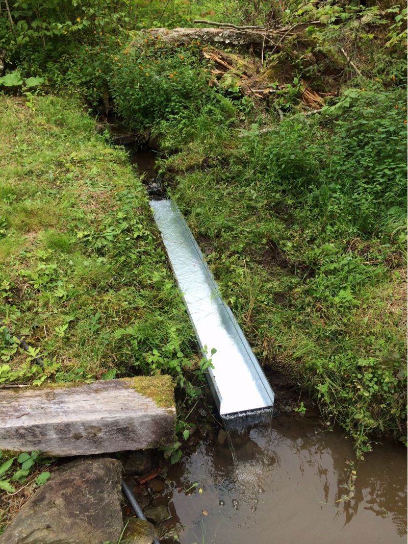

 | # Posted: 7 Sep 2014 07:07am Reply
 My water comes pure from the mountain behind my camp.  Been using it for drinking water since the 1970's.  Also, have  a 300 gallon holding tank for the taps in camp, gravity feed with about 10 psi.
