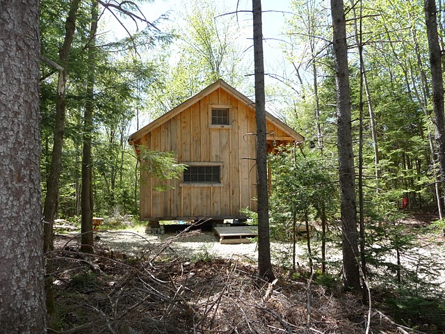

# Posted: 11 Jun 2010 10:18pm
Might as well add a picture of the cabin in question. This is a kit from jamaicacottageshop. The woman in charge helped me put it together about three years ago. (I'll try to get more pictures posted in the appropriate area.)
Thanks again for any thoughts for properly grounding in solid rock, and greetings from Philly.

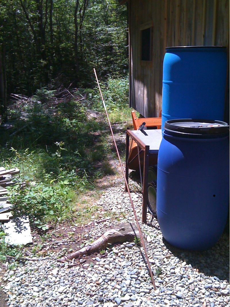

# Posted: 20 Jun 2010 11:14pm
This turned out to be easier than I thought it would be. I went in at a slight angle - running just above the ledge. (The photo here is not showing the exact angle and location that I sunk the rod.) Having a heavy duty maul was the trick to driving this down. Now I'm ready for some solar panels.
