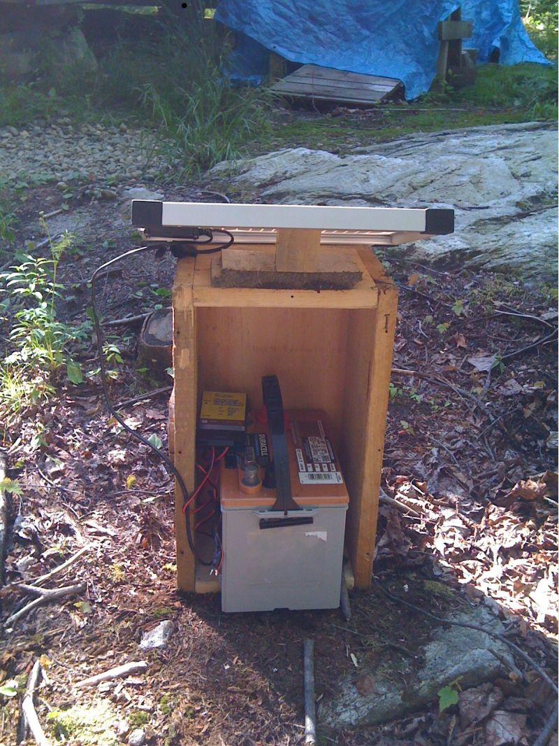

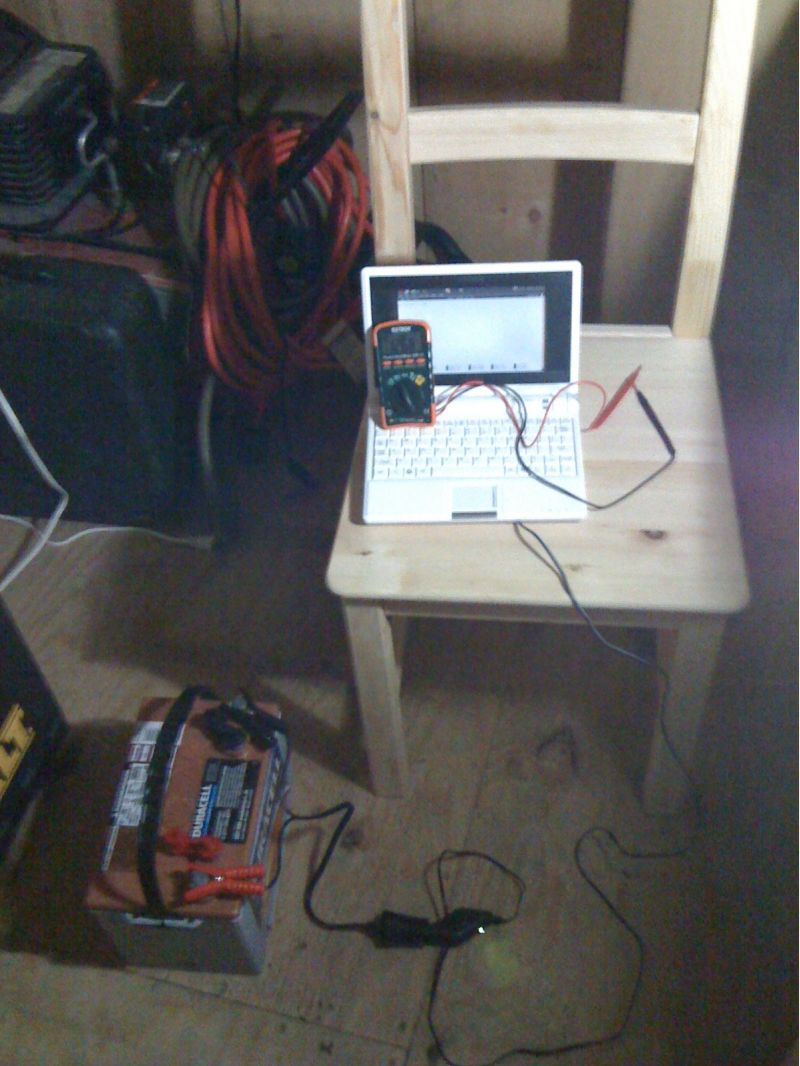

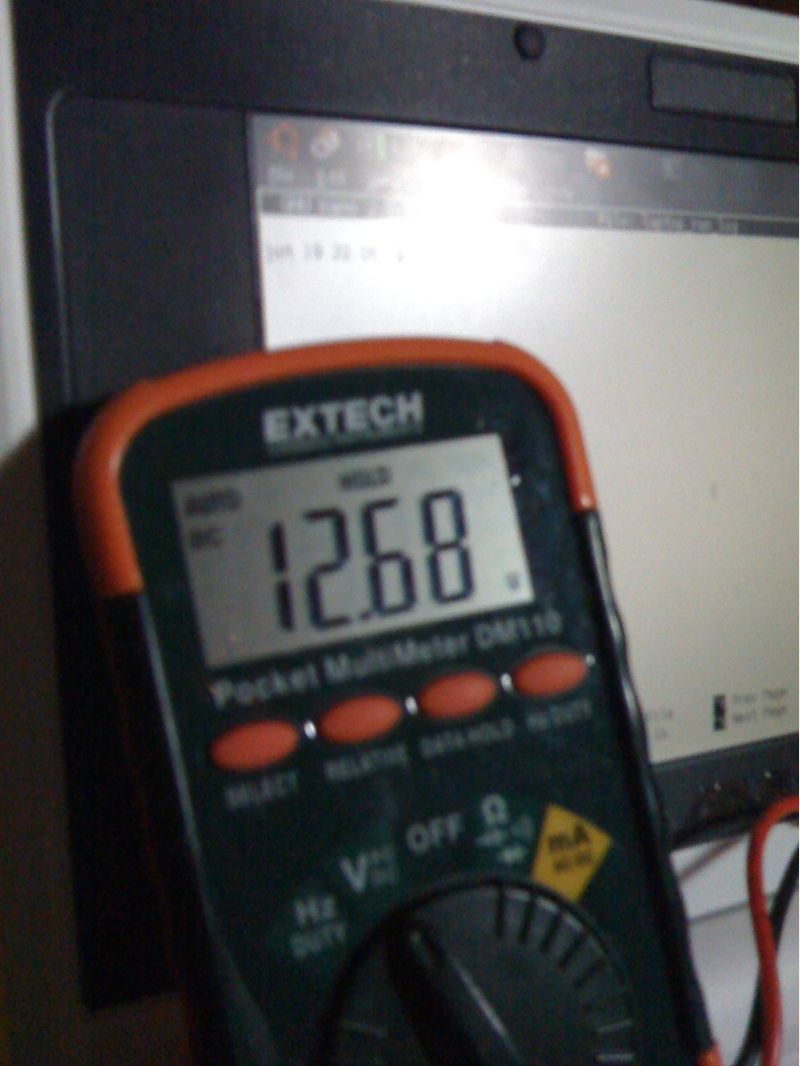

# Posted: 20 Jun 2010 11:43pm
Thought I post some shots from my solar laptop setup. I had a chance to get up to the cabin and test this weekend. The 5 watt panel is not nearly large enough, but it's OK for general testing. I just sunk a ground rod at the cabin so now I'm ready to properly add some larger panels to my roof. The PC is an Asus Eee PC 701. I have this hooked up as straight 12V, (no inverter) through a Radio Shack car charger which has selectable voltage and various size plugs. The eee PC has very little power draw, not sure of any laptop (netbook) that takes less. The netbook is running EasyPeasy (Ubuntu) Linux. I currently have a script that wakes the laptop, takes some webcam photos, then puts the laptop to sleep for 24 hours. I want to do a solar powered time-lapse photo shoot, like a trail cam, balancing battery power use and solar charge to the point where my batteries keep the thing running through the season.

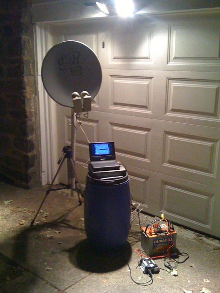

Sorry for hijacking the thread. Here's a test run of the used satellite dish I found on Craigslist. We're going to drag it up to the cabin this weekend and try our luck at hitting the sweet spot in the sky. We're using the spare receiver from our bedroom. The display is a DVD player that has a video input and it's own internal battery. I'm planning to bump up the battery bank soon, hoping to go up to four deep cell 6Vs. Not sure if I'm going to do a direct DC solar vent fan first - before upgrading the cabin's battery bank.
