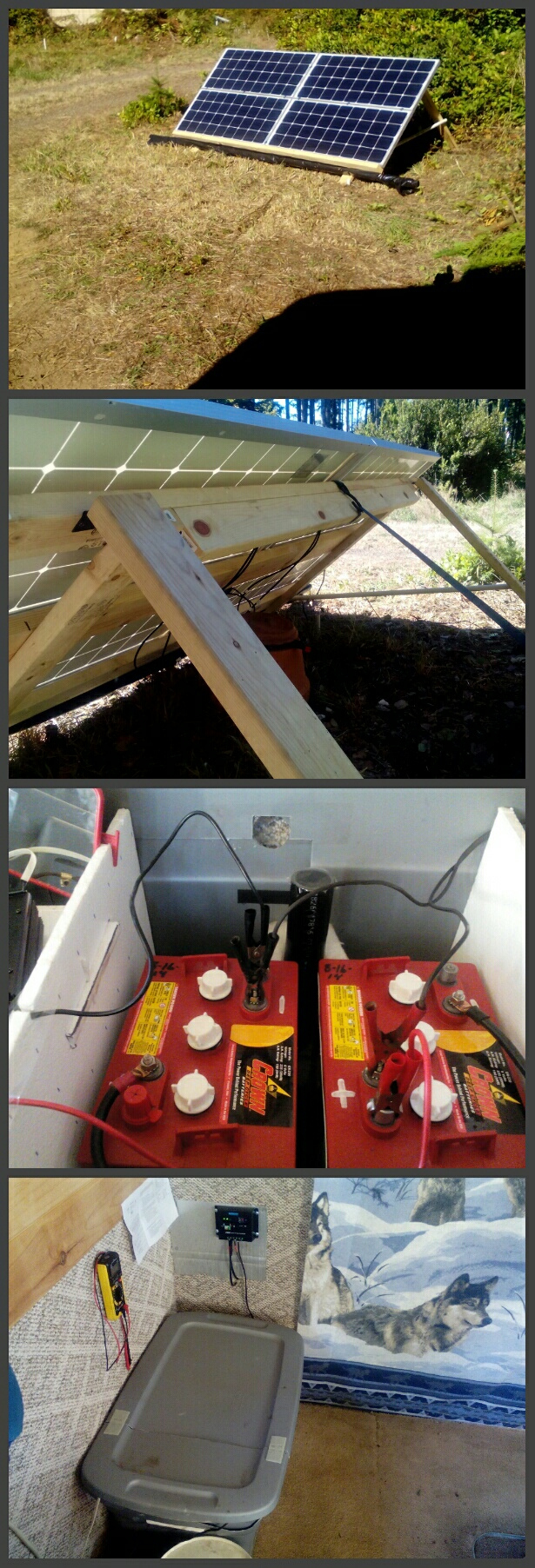

 Here are some shots of the system.
 1. Array on moveable platform with blackout curtain stowed below if I need to work on it in daytime to keep from producing power.
 2. Backside of rack with adjustable legs to allow for sun angle changes.
 3. Battery box with forced air vent that exhausts air outside when needed.
 4. All closed up with tiny charge controller in back and volt meter beside.
 All new battery box is in the works that will look like a storage chest but have a separate contained drain system and two piece upper and lower half for easier less lifting battery swapping.
