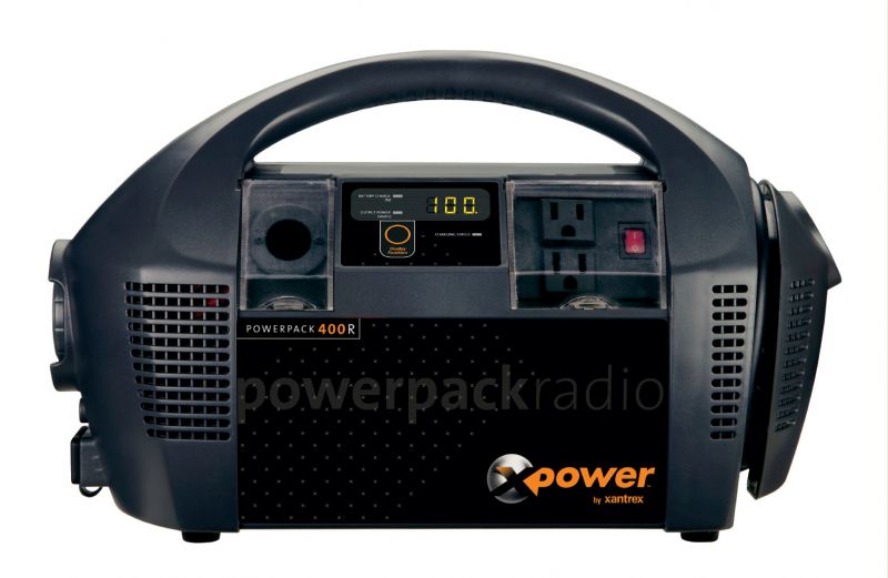

| LoonWhisperer Member
 | # Posted: 1 Oct 2014 11:28am Reply
 Scott, I have had an Eliminator Box for years (they are made by Xantrex and the pic below is their equivalent)  It is the model with the 400 watt inverter.  Outside of the crappy air pump, it has served me well.
 I am in the process of upgrading the power at my cabin as you are but do intend to keep this as a standby.  The replacement battery can be had fairly inexpensively.
 If you feel you can make use of it, grab it! Never hurts to have in a pinch.
