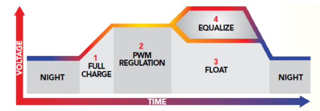

Greetings:
Recently, I read posts where some members stated the available sunlight for recharging their batteries as being only a couple of hours or so, per day.
Here at North Latitude of 13 degrees, I know I am at an advantage, due to having ample sun hours available throughout the year. Usually, I get at least 5, more often, up to 6 good hours of daily sun. I don't own a generator, or use wind or hydro.
I know how important it is for the batteries to have a full charge put on them. So, for those of you who live in more northern areas, how do you make up charge times, if you do not have a generator?
Four Stages Of Charging
