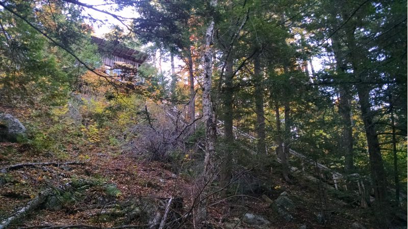

I just bought a cottage in Quebec (woohoo!), it has electricity but no water in. I'd estimate that there's a vertical lift of about 80 or 100 ft from the lake. I'm having a surprisingly hard time finding any suggestions online about what sort of pump to get. Most of the ones I've seen have a limit of 20 to 25 ft.

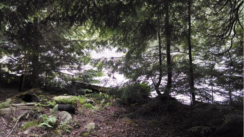

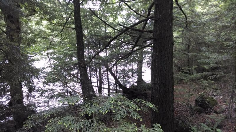

My geography is pretty much that I have 160ft of lakefront, and it's all at the bottom of the hill pictured in my first post, BUT my land flattens out for about 20ft (so there is flat land between the slope and the lake). As pictured below.
lake at bottom of hill
lake shot #2
lake shot #2
