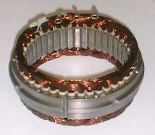

 I bought 20 acres up in the mountains of northern California a year ago and have been making plans and coming up with ideas.
 One idea about PMA's has raised a question that I haven't been able to answer.
 Maybe someone here can tell me if this will work or not.
 I want to build a 480v 3 Phase generator to run some water pumps on demand with no batteries.
 Looking into PMA's I saw they didn't really have the voltage and current I'm looking for, but they do have the right parts I think.

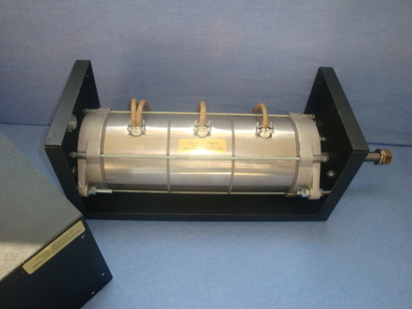

 Here is my idea. Take this Louisville Quad Core Alternator and put 4 of these SC120 coils in there which are rated at 600v at 5000 rpm.
 I'm thinking with four of these coils in there It should be able to produce 480v at a much lower rpm, and produce enough amperage to run the water pumps.
 The main plan is to test it with a gas engine and then build it into micro hydro generator.
 Does anybody know if this would work or is there another way to go about it?
 Robert

 I think these Permanent Magnet Alternators have a lot of potential. They offer several different types of coils each wound with different sizes of wire and turns ratio for whatever output you need.
 I did the math on four SC120 coils hooked in parallel and realized the frequency would be way to low so I started looking at the other coils they offer.
 It looks like the SC12 coils are what I need. One coil puts out 230 volts at 8000 rpm and has 71 amps.
 So according to my math four coils hooked in parallel running at 4173.6 rpm will put out 480 volts, 148.16 amps and have a frequency of 69 hertz.
 To me it looks like this would run the electric water pump motors on demand.
 I wish I knew enough about this to be able to say definitively that this would work.
 The reason I'm looking at these PMA's for a micro hydro set up is because they are way more efficient than the hydro electric generators offered in stores.
 Anybody have any thoughts on this? I'm a little out of my zone on this one.
