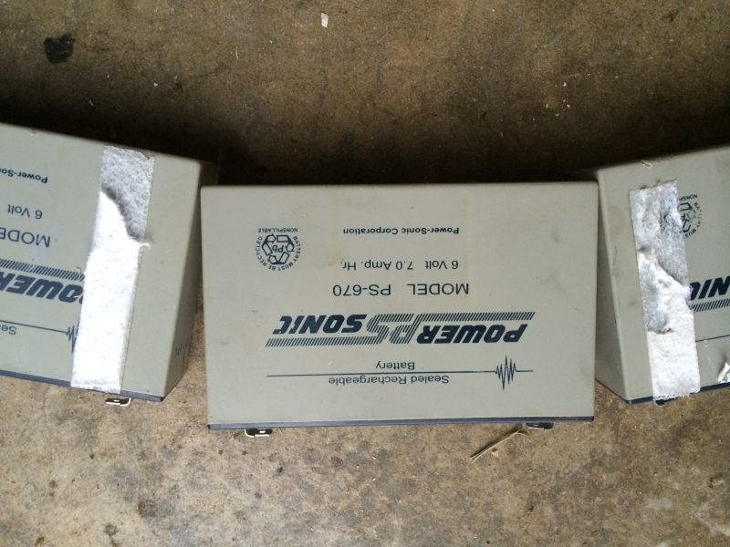

Found 3 batteries sitting in the garage. My thought was, if they hold a charge, using them to light the outhouse. Run them in series to power a couple 6v lantern bulbs, add a switch and then the fun part..... wire one of those cheapie solar power cell phone charges to keep them powered. Looks like the charges put our 5.5v, and one I saw was weather proof and had gromets to hang it under the outhouse overhang. First question is the line out of the charger looks to be USB. I wonder if I could just cut that and have 2wires to tie into the batteries.
