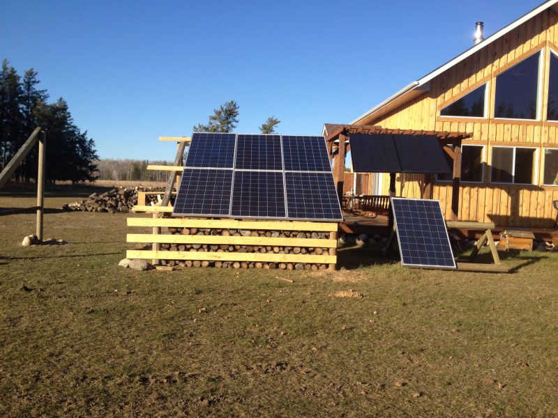

 We got 6 new solar panels this year to add to our grid. They were just on the ground most of the summer on small stands, while we tried to decide where we should put them. Then it came to me, we need a bigger wood shed, and the panels make a big roof. We will start splitting wood in the next 2 weeks, so know was the time to build. Knowing that we will and 6 more panels next year we have dug the posts in for the next phase. Only problem buying panels at different times, they very in size slightly.

 Quoting: MtnDon Cool!   When buying panels at different times the other thing that needs watching is the Imp and the Vmp ratings, IF they are to be connected to the same charge controller. they are all the same Imp and Vmp connected in MidNite Solar Combiner.
 This is what we have right now
 Deep Cycle Batteries 8
 Solar Panels250PE Watt SP 9
 Inverters Magnum AE 4000 watt 24 VDC 120/240 both Inverter with 105 amp charger
 Charge Controllers
 Windmill 600W Wind Turbine Coleman
 next year hopefully 6 more panels 2 more batteries.
 We want the panels to be low for cleaning, but not an eye sore.
