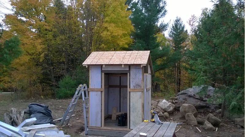

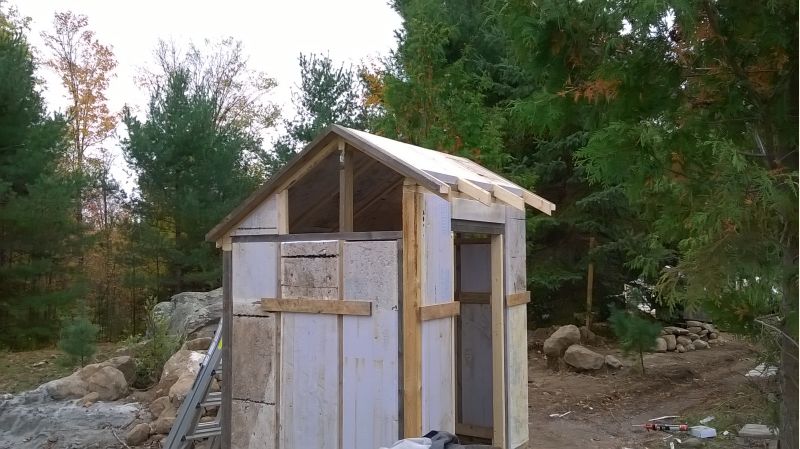

 Here's a couple of pictures of the Pump House being put together:  Using 2.5" Roofmate R-12.5 panels Times 2 for 5" total R-25  (even under the concrete pad)
 foam panels almost completed, this is before the 2" inserts covering over the joists.
 Hope it Helps
 |  N & S panelled with foam
 |  N covered with OSB (see wellhead in centre)
