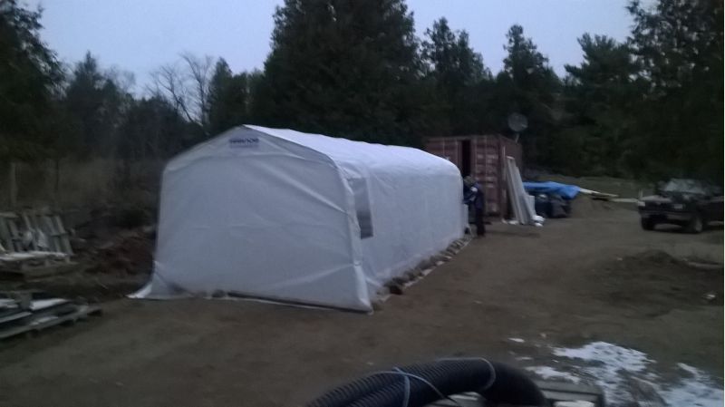

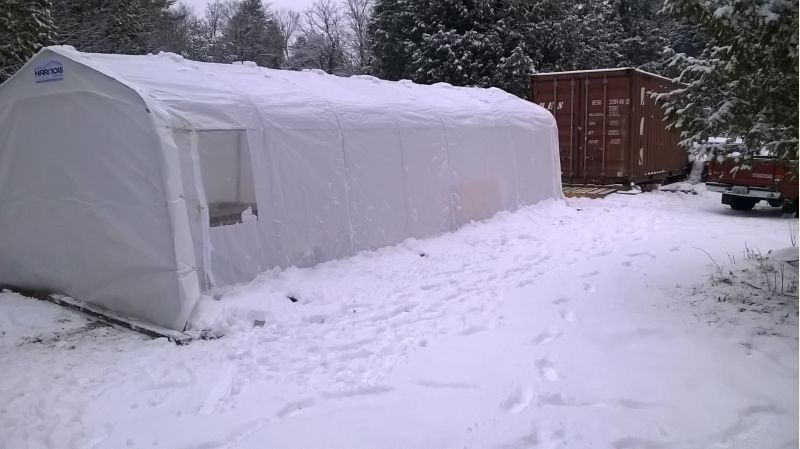

 As you can see, we got in "Just Under the Wire" with the Shelter.
 ANYWAYS, This is getting far off topic...   Back in the Ugly Big City and finishing "dumping" the townhouse contents and on Friday moving to the Apartment in the little village not far from Cabin Site.   Won't be travelling back to the city of 1 Million Plus again unless I absolutely and totally have to... and even then it will take some coercion to do so...
 |  Shelter UP safe & sound (SUNDAY)
 |  Monday after Mother Nature had her first Hissy Fit !
