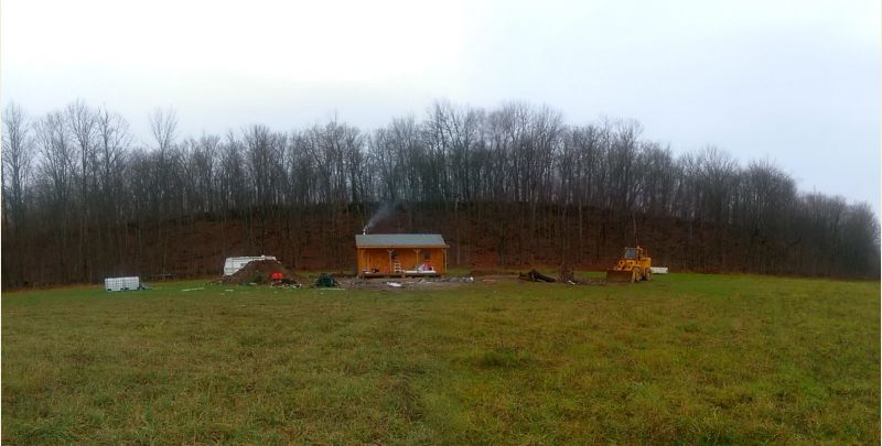

 Hi there, I have been working at getting my life going off the grid and have been lucky enough to get my hands on 3 trojan t-31 gel batteries, otherwise all i have is there infamous HBF 45w kit... I am trying to build a system around these batteries that will make the most of them and perhaps let me even run a fridge one day, i have all 12v led's in the cabin and will only run a led tv, xbox360, and charge my laptop. right now, after spending an arm and a leg on a to code chimney for the woodstove, I have about 600$ to invest in my system and want to be strategic in what I buy as to be able to keep expanding, as I save money.  ...and i know i'll have to ditch the HBF controller... which should i get, i do have a modest generator which Id like to help charge the batteries.  Please shed some of your infinite wisdom!  Greetings from eastern ontario!
