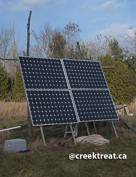

 looks good. i forgot about this post and started another similar. oops.
 here's my 60 degree angle from the other post. I see about a 30% increase in power from the summer angle to winter (tested summer 2014). Or about 15% by season. Kinda neat. When I went from summer to fall and fall to winter ... on my movable array ... I saw "current limiting" the next day in full sun. Which indicated a marked improvement in power production.
| groingo Member
 | # Posted: 2 Dec 2014 10:40am Reply
 Is the power uptick because of angle or the cold weather which is typically good for the 15%?
