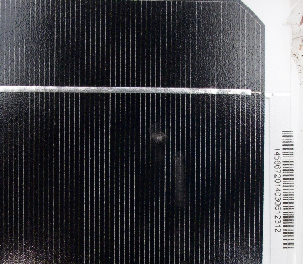

 If one cell has a broken lead is that cell dead?
| MtnDon Member
 | # Posted: 20 Dec 2014 10:09am Reply
 If that is really a conductor break, I would think so. But the real question is whether or not that cell is in series with others and if the string is 'dead'?  How does that panel output compare to others of the same type?
| groingo Member
 | # Posted: 20 Dec 2014 12:49pm Reply
 Don:
 Output is normal on this overcast rainy morning at 18.93 which is right where it should be when compared to the others.
 First thing Renogy said was, don't worry, it's under warranty which was refreshing, they offered to give a credit on the panel cost or would replace it at this point I was considering buying two more panels anyhow so may just use the credit towards that.
