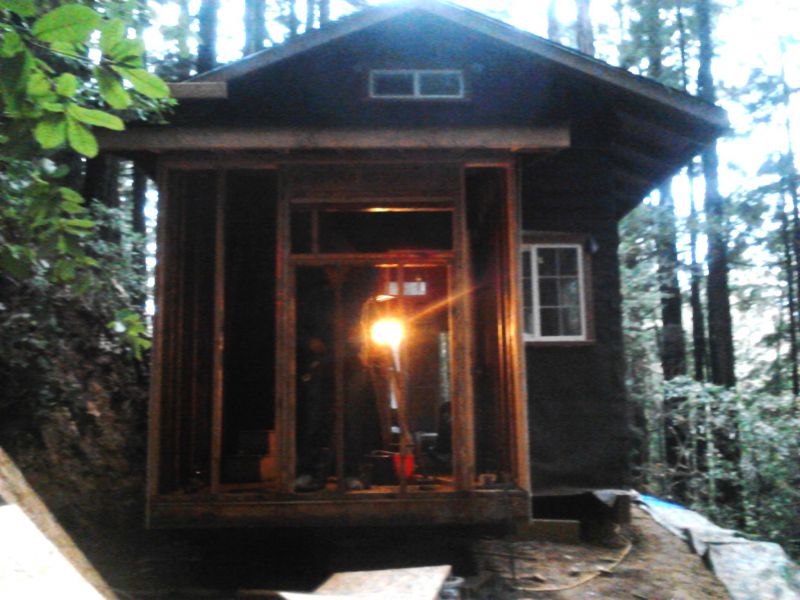

 I'm also getting to the point where I need to decide on a crapper.  Scabbed a 6x8 room on the back of my cabin.  As you can see, steep drop off below, and I'm thinking I can run a pipe at a fairly steep right from the toilet down the hill, and my road goes right by at the bottom (about 100 ft. down).  So if I use compost I can put the tank away from the cabin but need help getting the stuff down the pipe right?  Other options?  Thanks.
