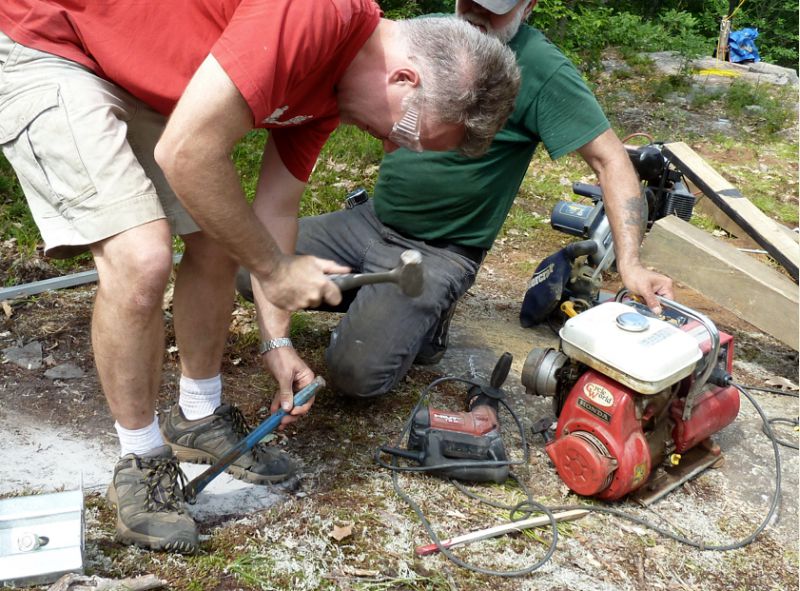

 I built our entire place from drilling the bedrock to compressor and table saw with a honda EG1500. I bought it used for about $50 and it will not stop!
