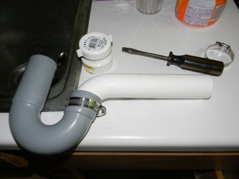

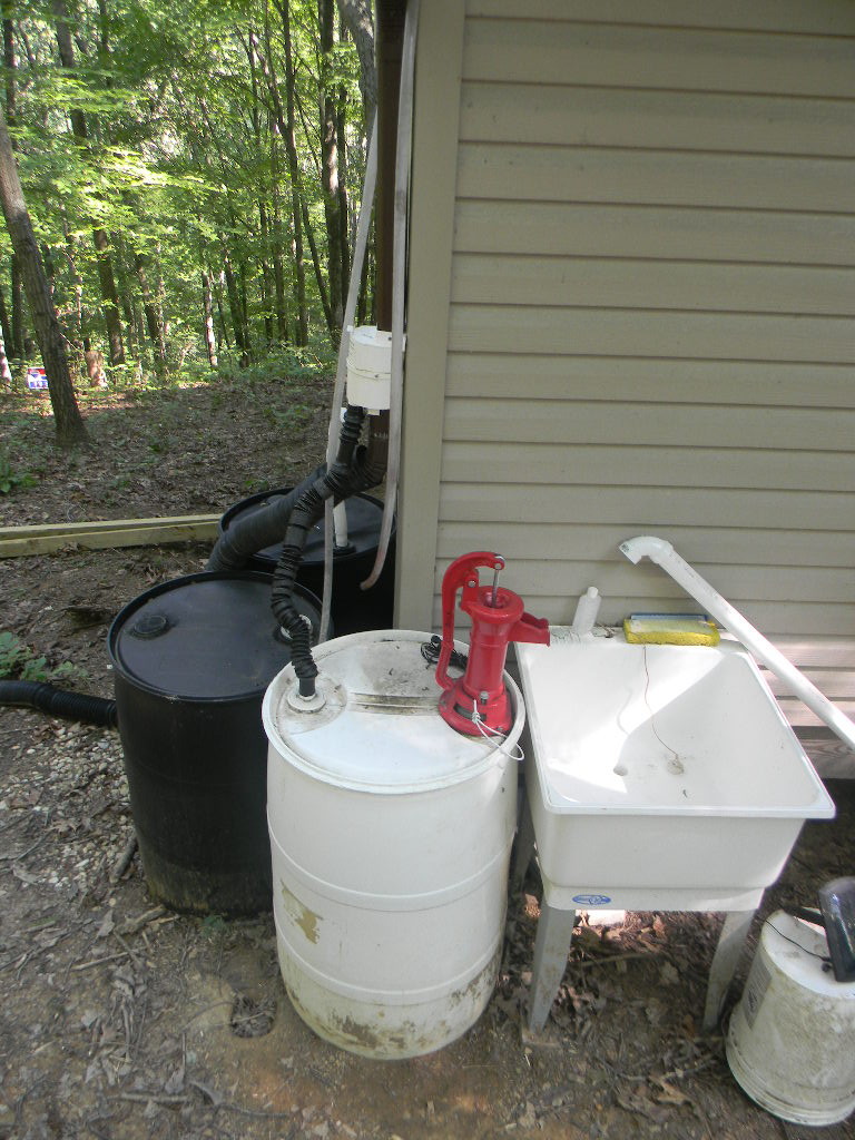

 We are weekenders mainly with the occasional weeklong stay.  We also like simplicity and minimal stress.  For wash water, we use rainwater collected in 55 gallon barrels.  Atop is mounted a pitcher pump.  When one is done hand pumping, the water returns down to the barrel, and a freeze won't split the dip tube or damage the pump.  Downside is that when the barrel is frozen, we get no water.
 We have a 5 gallon water container at our indoor sink, again with pitcher pump.  We refill this pump with city water (we bring 5 gallon containers for drinking/cooking).  The sink has a rubber sink trap which can freeze without damage.  No antifreeze required, nor winterizing with our setup. When we leave the cabin, we lock the door, that's it!

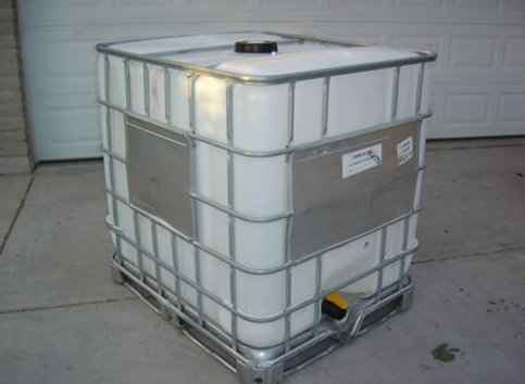

 Food-grade 55 gallon barrels are available from many cola bottlers.  Or local bottler wants $5 each. Larger water containers (totes) show up on Craiglist, but buyer beware as to what was previously in them!  A container in a pit with a strong cover would be a nice upgrade and would offer some freeze resistance.
 |  Freeze friendly water supply
 |  Freeze friendly sink trap
 |  Larger water supply
