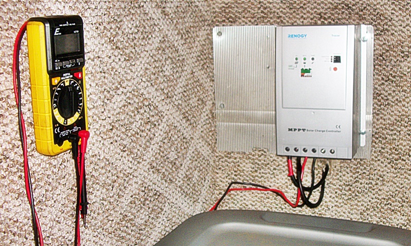

This is a first for me....USPS delivered on a SUNDAY!
This one was way different than the one I had previously gotten from Renogy, this one was double boxed, the controller was in a Tracer full color retail box and not just a brown box, it was bagged with a seal unlike the other, no greasy fingerprints on it, and the real big difference.....it WORKS! One thing I neglected to do was get the Rj45 meter but that has already been ordered. It's an easy set and forget setup.....will give it some time to get settled in but it is off to a much better start.

I ordered the Meter for this controller because my laptop is just to cumbersome and I want to see whats going on at all times with a push of a button. [img=null]null[/img]

This is as big as I can see for the future, my key problem has been getting enough juice to the batteries (panels were producing plenty but PWM was the snag) getting the batteries to take the power was the problem, thus far this controller is definitely making a positive difference.

Creeky: Thus far it is behaving very well, the meter will help verify the obvious and that is even while using juice it is blinking battery fully charged and in fact when charging I noticed that if I had something drawing on the batteries they seemed to perform better.
