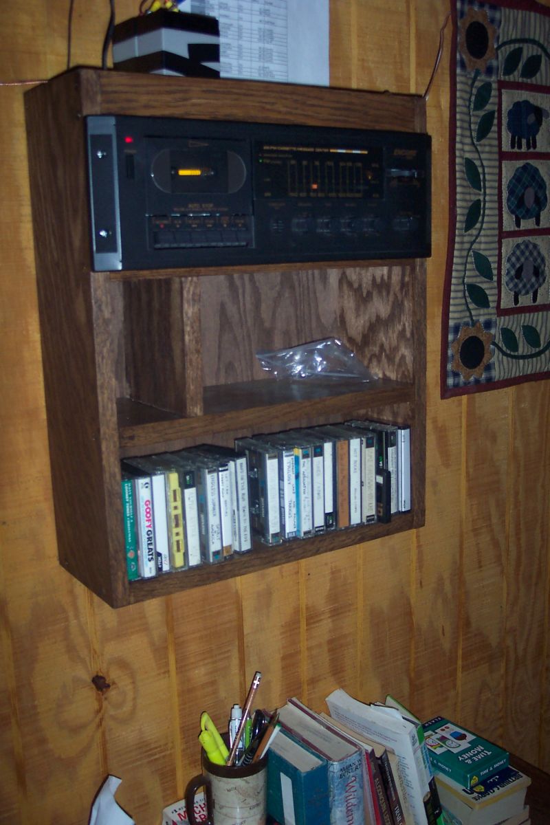

# Posted: 14 Nov 2010 08:51pm
I purchased an older RV AM/FM/cassette stereo at a garage sale. It runs off 12v, and has hookups for two speaker pairs (I've set up a pair indoors, and will have some outdoors for the covered deck). In FM use, the stereo pulls about .1 amp per my meter. The cassette will "eat" more. With a 4 amp-hour battery, I'll get plenty of use.
The car/RV radios should have power use ratings on them. Look for one with low current draw or low wattage to maximize battery life.

SE Ohio
# Posted: 1 Dec 2010 07:17pm
12V Cabin stereo as installed. Draws no power in off position, uses minimal current when on. This came from a RV store junk sale, but works well, and is unappealing to a burglar!
