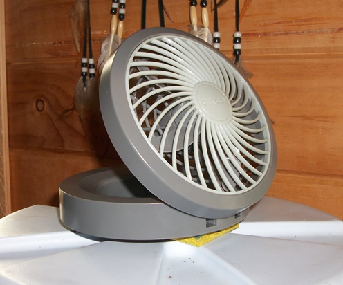

 | # Posted: 10 Apr 2015 12:41pm - Edited by: groingo Reply
 This is the one I picked up, runs great right from the USB port on the inverter, is actually now using 1 watt...must be broken in.
