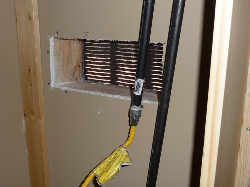

 Quoting: MtnDon I can dig up pictures if anyone wants to see what I did.
 Don, if you don't mind, I'd like to see this chase you built. I'm not sure if I'm following this thread correctly, but are you saying if you have a non-vented propane fridge, as do I, you can build a vent system via a chase?

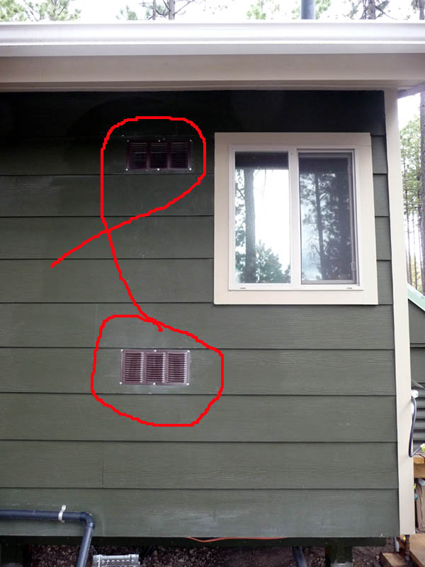

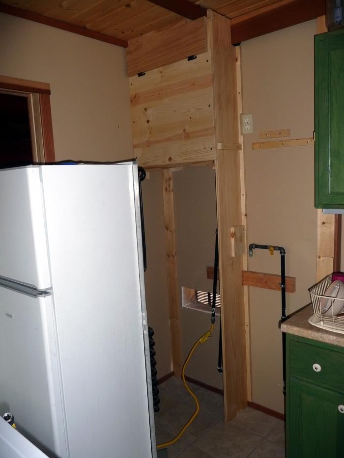

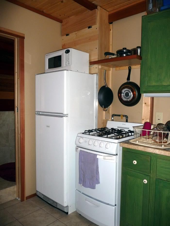

 Okay, here goes. 9 pictures. Pretty much self explanatory... but here are some comments...
 picture 2... The lower vent is not at floor level. I kept it higher to help head off any issues with wind gusts that might affect the burner. It has worked well. Never had a flame out even once.

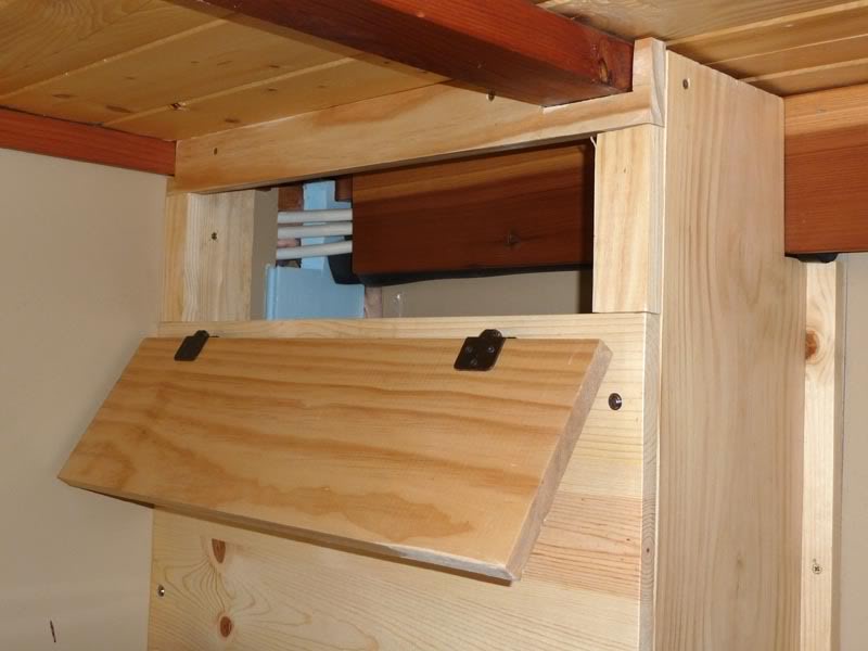

 picture 4... The condenser fits quite tight to the wall. The idea is to force the rising air behind the fridge to pass through the fins to be most effective at removing heat. I added a section of foam rubber that is stuck to the wall later to make an absolute tight seal between the condenser and wall.
 more images in next post.
 |  vents on the exterior wall
 |  lower vent, inside
 |  chase
 |  condenser clearance

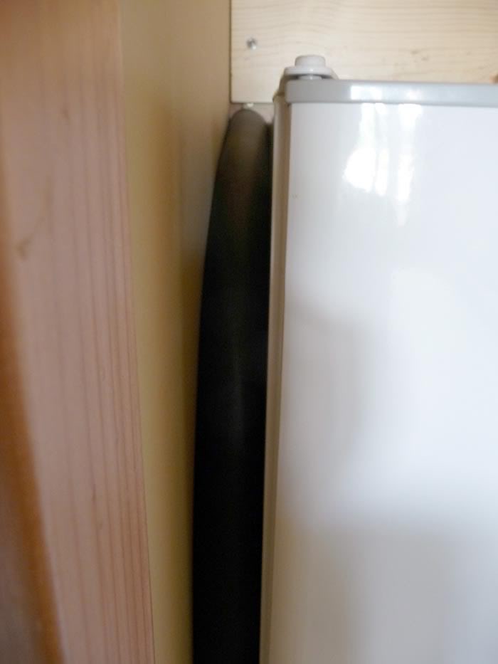

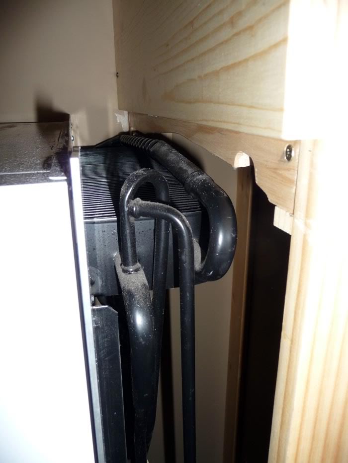

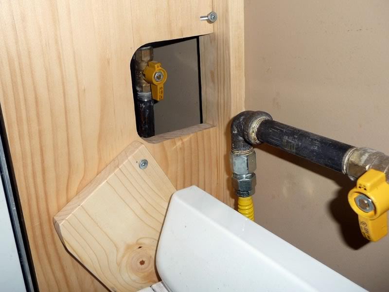

 picture 5... the left side, against the wall is blocked with a length of pipe insulation when we want to vent to the exterior. There is also a short section that fits between the case bottom and the floor.

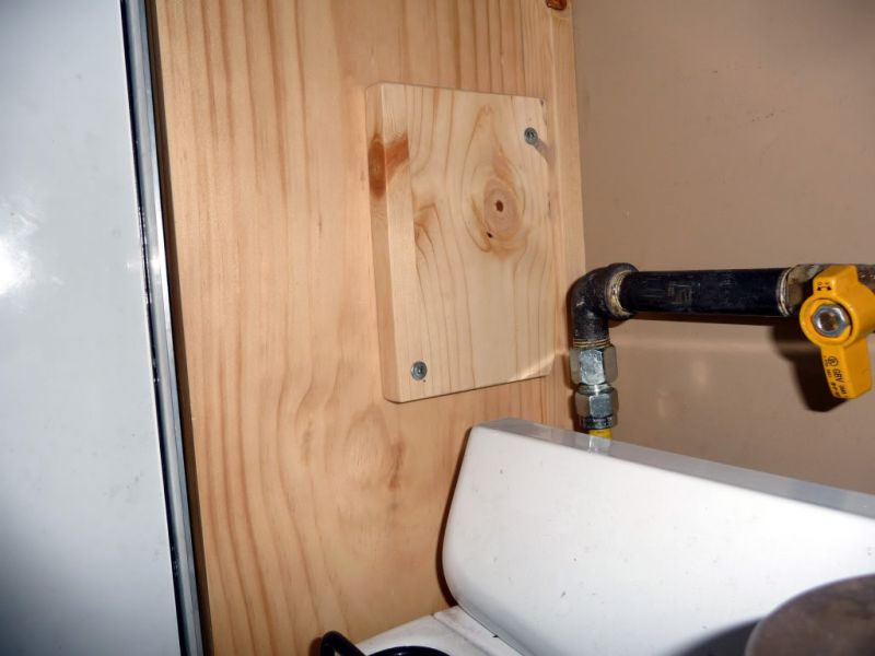

 pictures 6 & 7... a hatch in the chase side permits access to the gas shutoff valve.

 |  pipe insulation gasket
 |  gas valve access port
 |  gas valve access closed

 Thank you, Mtn Don. That's quite an elaborate setup. So my understanding of your explanation  is that you choose by season whether to vent inside or outside?
 I know from previous conversations that you are not a big 'vent free' proponent. Can I take it from your description, then, that outdoor venting of a fridge is more for convenience sake in warm weather and that you aren't as much concerned with non-venting of the fridge during cooler seasons, as you are with propane heaters?

 A propane fridge uses so little fuel per hour compared to a space heater I decided there was not much to worry about. With that backed up by two CO detectors I don't give it a second thought. The other thing that an unvented space heater does is the large amount of water vapor released inside. Again the fridge volume is so low any water vapor is unmeasurable.
 Yes, in the case of the fridge one of the big advantages was to route all the heat outside just like in an RV, when the heat is not desired to be added to the interior. Switching to inside or outside venting is a difference that can be felt.
