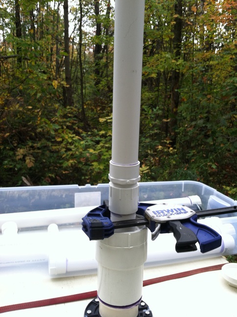

 Have had good luck so far with the synthetic plastic Oasis Pump.  http://www.oasispumps.com/
 Tried a cast iron with leathers but did not care for the performance, continued priming, and the slick on the surface of Neatsfoot Oil (found out the mfgr. conditioned the leathers with this stuff only by calling them - nothing in the literature - no thanks, I don't care if oil from the lower legs of a cow can't harm me, I don't want to see it on my water)
 We only go up 4 times a year so it is no surprise the leathers did not hold up.  We are fortunate to have a 20+' deep dug well that has blue clay down to sand and gravel at the bottom.  This pump suits it fine.  The water is incredible.
 I know there are hunters and others that trespass when we are not there but they have never messed with the well or other structures.  But I still wanted a pump I could easily remove for peace of mind and to eliminate freeze potential.  We installed the cast iron "Can't Freeze" pump with no foot valve and it only held prime and the water for 2 trips one summer.

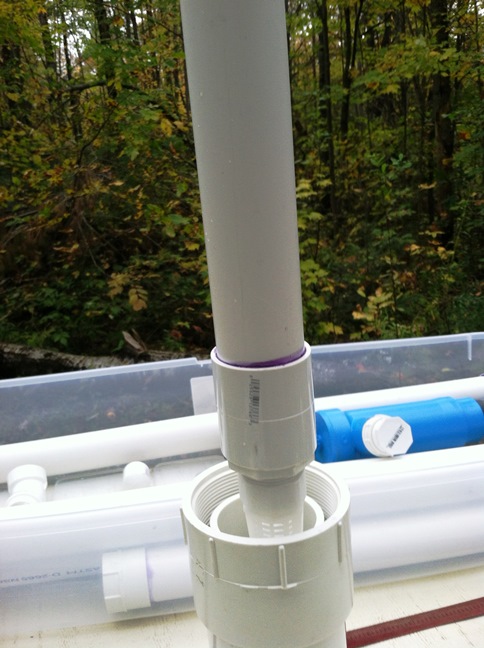

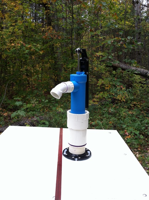

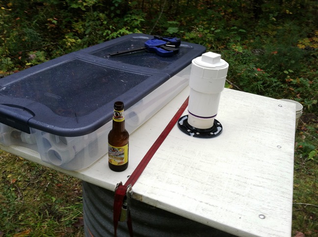

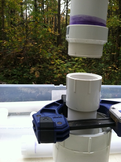

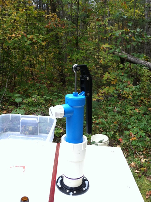

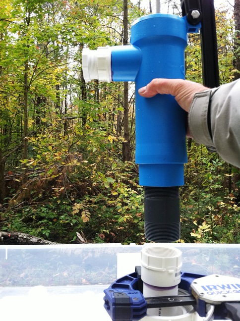

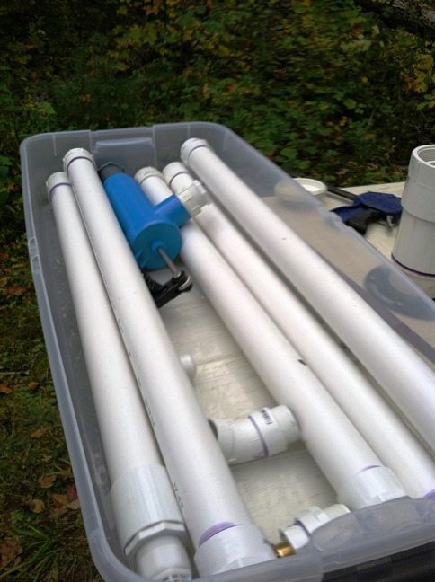

 I used the spigot closet flange (stainless steel bolted to the cover), a variety of fittings to create a 4" threaded security cap, and the foot valve.  Located a long, shallow tote and cut the riser pipe sections to fit in the tote.  The pump, various fittings, and all riser sections fit in the tote that slides under the bed.  The outlet is threaded and I can thread in the 45 deg. fitting for the bucket or a garden hose.
 We just thread the riser sections together and soon have water.  The pump base sits on the 3" fitting inside the 4" piece after the cap is removed.  I didn't use pipe dope on the threaded sections and just tightened by hand.  Turned out that the lack of pipe dope allowed water to slowly drain out to the level down in the well but the foot valve and the draw of the pump was enough to slowly raise the water so that priming wasn't needed and prime was not lost until several hours later. I'll try to post pictures later.

| JH Fish Member
 | # Posted: 17 Apr 2015 09:08pm Reply
 1st set
| JH Fish Member
 | # Posted: 17 Apr 2015 09:10pm Reply
 2nd set.
