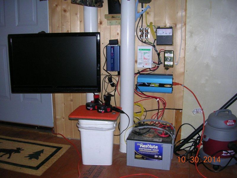

| kdrtk Member
 | # Posted: 9 Jun 2015 05:30pm Reply
 I know you inquired about a generator. Just wanted to point out that there are 12 volt Flat Screen TV's available that can run off a small solar system. This is a Naxa 12 volt flat screen with an internal DVD player that I installed couple years ago at the shack. Gets used frequently. I usually have it swung in front of the inverters, etc. but was using the inverters at the time of the picture. Oh, and the solar is totally quiet.
