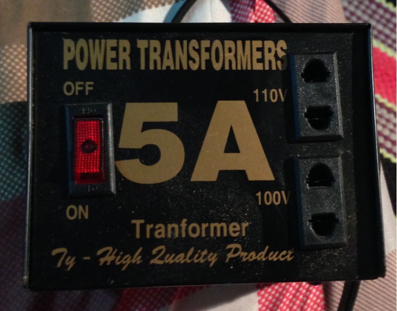

| ILFE Member
 | # Posted: 5 Jul 2015 04:07pm Reply
 Quoting: Bzzzzzt Sorry Creeky, but as an electrician I have to point out (because I'm OCD like that) there is no 110V. It's 120V.
 In the US, yes. Here in Cambodia, and elsewhere in Southeast Asia, for some odd reason, they have voltage transformers that convert 230vac, down to 110vac OR 100vac, from the same voltage converter. Not really sure why they have them set up like that, here. But, it is quite commonplace.
 Oh, you can ignore the "High Quality Product" line. They are junk.
 |  Vietnamese Power Converter
