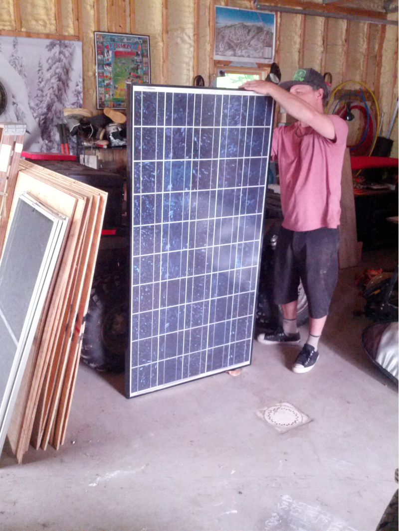

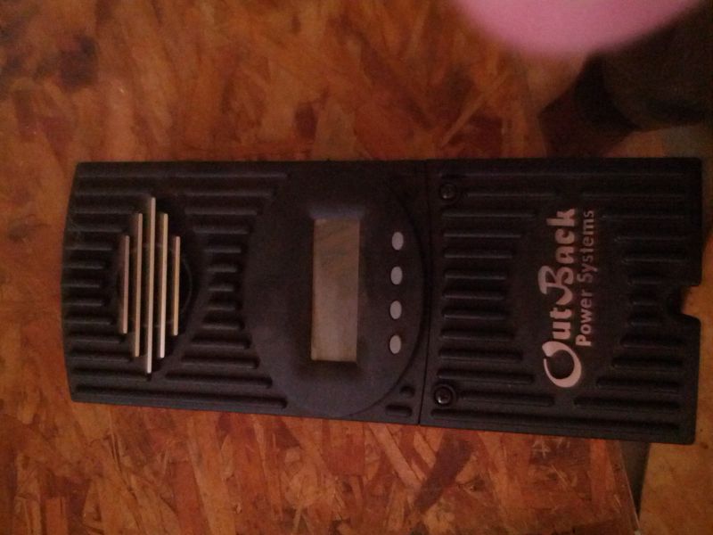

I just bought a little piece of property that is off-grid, and I'm going to be building a small cabin. My neighbor is selling his 7 year old solar system (he just installed a bigger system). It consists of 8 Mitsubishi 180 watt panels (PV-MF180UD4) and a 60 amp Outback charge controller (MX-60-MPPT) and an aluminum panel rack and head which mount on a 6" pipe. He's asking $1500/obo. Includes only these components (no batteries, wiring, inverter, or 6" pipe). Seems like a decent value?

Personally, I'd say if everything works as it should, you didn't do too bad at all. My rule of thumb, when I was shopping solar was that if you can find panels for less than a buck a watt, you're ok, and of course, the cheaper the better. That controller new I'm guessing was pushing $1000 7 years ago? There are good solar experts here. They'll tell you the truth. But I prob would have made the purchase👍

How long do charge controllers last? Is it 75% thru its life? In that case you are paying $1 per watt with little else.
Are Mitsubishi panels high quality? Cheap panels have a high failure rate, good panels will last your lifetime.

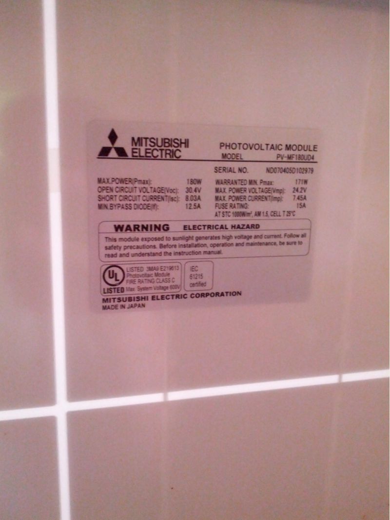

So the panels are probably about 10% decayed. So call 'em 160w x 8 = 1280 watts. tho it wouldn't surprise me to see them go higher.
used panels. say .60 a watt?
used controller. that thing should be good for many a year more. 25 year life I would think. and a good quality name. 1/2 price be fair?

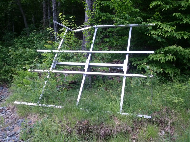

the racking needs one piece replaced. not a big deal. check for stress fractures, but that bend looks like a "oops hit it with the tractor" kind of failure. so no big deal.

If you could get it for $1100, I would do it. $.50/ watt on the solar and you are giving him 400 for the CC. Good deal for each of you. That racking, he needs to throw it in on the deal as it is damaged. Those panels are 24 volt grid tie so they will treat you well. Just my $.02 and I am a cheap bastard.
# Posted: 17 Jun 2015 04:14pm
Quoting: creeky used controller. ...............1/2 price be fair?
Half of today's price. Today's new price is $485 at NAWS. And new ones come with a 5 year warranty.
