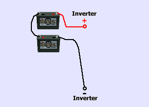

 Hopefully these diagrams below will help you.
 |  2x 6 volt in series for 12v
 |  4x 6 volt in series for 12v

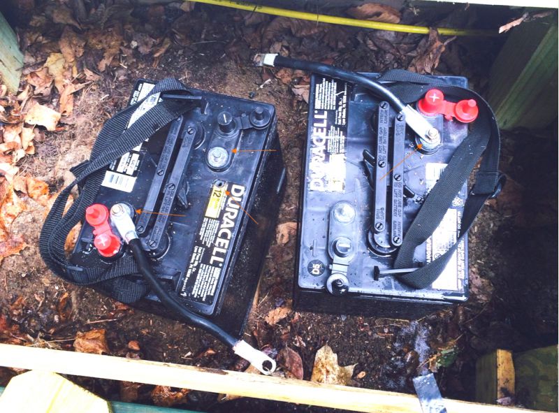

 I'm attaching a piccy of the batts so you can see the hole and the shorted post. I've also got arrows pointing to the two welded posts/nuts, though you can't see how neatly they are welded.
 So my problem now is, I can't get the caps off the cells because the slide mechanism is blocked by the welded posts/nuts. I wanted to check to see the condition of the inside of the batts, but no luck. Can I assume that welding is welding, and the only way I'm gonna get those cables off is with a hacksaw?

 Honestly and sadly, take those batteries in as Cores and forget'em...  I'd wager $50 the plates are cooked and THAT would be a suckers bet.  Seriously don't waste any more time on them.

 It may be a long shot but don't give up without finding a good battery shop first. Melted posts can be rebuilt. A hole in the case does not necessarily mean the insides are melted / toasted. You may or may not have a shop that can handle that locally, but it is worth a look first. I have seen a post that was melted almost flat re-poured.
