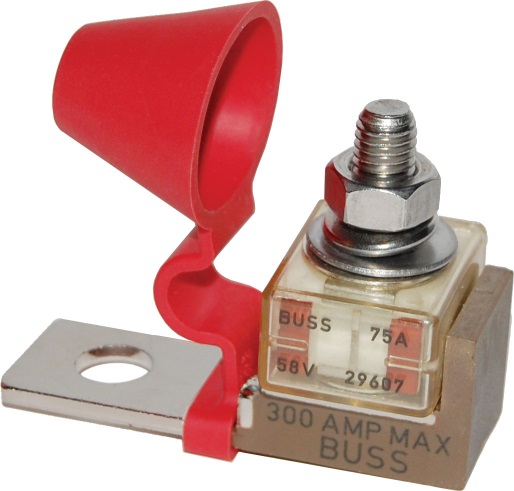

My favorite method for fusing batteries is the Blue Sea terminal fuse block. Attaches directly to the battery, so it's as close to the battery as possible. Fuses are available from 30 to 300 amps.
